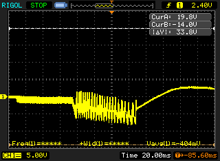

I was just doing some more testing of the motorware software and came across something I don't fully understand. When running my motor with a load (propeller) and I command a reasonably large step change lab11 will sometimes fail, but lab10a works fine. By failure I mean the motor makes a horrible squealing noise then the driver faults.
For example, stepping from 2400rpm to 3750rpm will more often than not cause a fault in lab11. In this case I am powering the board with a bench supply with the current limiter set at 20A and about 130,000uF of extra bulk capacitance. If I switch over to using a battery with no extra capacitance it works 100% of the time but failures still occur with larger step sizes. When a failure does occur I can observe a very ugly voltage transient on the supply rail.
Doing the same testing with lab10a the failure never occurs, even when commanding changes from very low speed to full speed. The transients measured on the supply rail are MUCH less extreme than the fault case of lab11. I plotted the RPM (measured externally) vs time for both labs and found the response to be identical. In my application it is critical to have rapid response to changes in commanded speed.
I know that lab11 is missing the trajectory controller. In lab10 I have MaxAccel_krpmps set to 32. Is the lack of the trajectory control the root of the problem in lab 11, or is there some other factor? Maybe something like slew rate control on the current loops?
The voltage transient is different. Attached is a plot of a transient during a fault.
The thicker portion that starts halfway through the first division I see in all cases. The really ugly stuff that starts around the 4th division I don't see when there is no fault. At around 7.5 is I think where it gives up (undervoltage fault) and the motor coasts to a stop. In this case this is AC coupled 5v/div
I also confirmed this problem is not present in lab11a.
Nominal voltage is 15v, but I am using the LAUNCHXL-F28027F+BOOSTXL-DRV8305 setup. The problem is NOT present in lab11a.
I think this is related to overmodulation issues. lab 11 does not have any of the overmodulation changes, as 11a does. Try the attached document, where I got 11 and added overmodulation changes.
