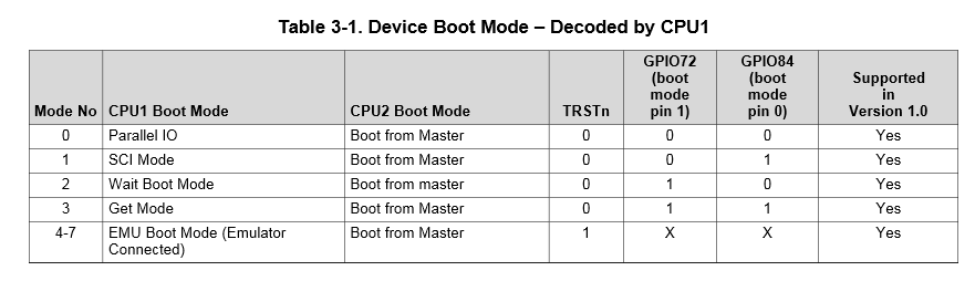

  • Im a little confused, setting to GetMode using the switches means TRSTn is 0 and the debugger will not connect? Doesnt TRSTn have to be 1 for me to be able to connect to the debugger and store to flash?
    EDIT: Thinking on it, knowing that I can use GetMode to read my program from the flash, what I should be asking is how to I now write my program to the flash?
    -Bryan
  • Bryan,
    Setting GetMode does not mean TRSTn will be '0'.  Table is showing two different case here. One when emulator is connected and in that case TRSTn will be driven '1' by emulator (hence table has value '1') and other case is stand-alone means no emulator connected so TRSTn will be '0' (hence table has value '0').

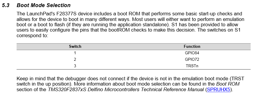

  • Hi Vivek,
    As I understand it, switch 3 is setting TRSTn so when I set the boot switches to '1 1 0' (GetMode?) it will not connect to CCS for debugging I think this is also mentioned in the text above the table.
    Unless I set GetMode another way?
    -Bryan
  • Hi Bryan,
    Ok, I see what you mean. Emulation BOOT further has different boot mode settings and has Get Mode setting based on the value written at address 0xD00. Please refer "Table 3-3. Emulation Boot (TRSTn == 1)" and "Table 3-2. EMU_BOOTCTRL Definition"  in TRM for more detail about this.

  • Hi Bryan, Aditya,
    There's been some confusion in this thread.  I'll try to help clear things up.
    1) For the emulator to program/connect to the MCU, the emulator needs to be able to control TRSTn and the various JTAG pins.  No GPIO settings matter*.
    2) For the device to boot from FLASH, TRSTn must be low and the boot GPIO (72 and 84) must be set in Get Mode.  Unless special things are done, Get Mode will be Boot-to-FLASH.
    3) The simplest path to using the kit is the following.  When debugging or programming the FLASH, set S1's switch3 to ON. Then change it to OFF when you want it to boot from FLASH standalone (cold boot).
    4) When you load to FLASH with the emulator, you have the ability to run the code from FLASH and debug with the emulator connected.  This won't run the initial code that would run when a cold boot occurs, but it is often close enough.
    5) If you need to "emulate" a cold boot with a debugger connected, Vivek provided some of the detail necessary to do this.  This is often only needed if (4) works, but cold booting from (3) doesn't.

  • Hi Brett,
    Thank you for shedding some light on this subject.
    I understand all the points however my method for 3 is not working.
    Im setting up the launchpad as in 3, switch3 on, connecting to PC and CCS, building CPU1_FLASH and debugging the program but then im getting the following error when it loads:
    C28xx_CPU1: GEL: File: C:\ti\controlSUITE\device_support\F2837xS\v190\F2837xS_examples_Cpu1\gpio_toggle\cpu01\ccs\CPU1_FLASH\gpio_toggle_cpu01.out: Load failed.
    Ive navigated to the location and the file is present, is there any further help you can offer me with this?
    Many thanks again,
    -Bryan
  • Ok, solved that, I wasn't erasing the Flash before programming it. Its working fine now.
