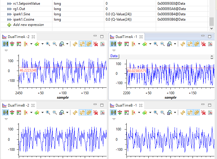

I am trying to simulate PMSM TI implementation (HVPM_Sensored), on f28035. I have imported the project and then on debugging at first attempt itself, buld level 1 didn't work. I'm including a screenshot of the debug session, ipark1.Sine and cosine are showing 0 at the same time (Are they average values?). I'm a newbie to this area. Please help ASAP.
  • did you write EnableFlag to be 1 ??
    Actually i solved the issue.
    FYI, i have enabled the EnableFlag to 1. But there is a piece of infinite loop in the code. Which when commented, gives the result.
    Thanks for your response.
