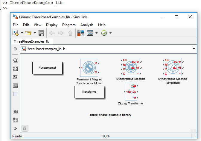

  • Hello Brian,
    Thank you for your answer. I have already request a trial version of the Simscape Electronicst to test the FEM-Parameterized PMSM. I did not find the ThreePhaseExamples_lib which you mentioned in your answer. Can you tell me where i have access to this Example?
    Tobias
  • Hi Tobias,
    Just type ThreePhaseExamples_lib at the MATLAB command line to open this library.  See below.
    Cheers,
    -Brian
