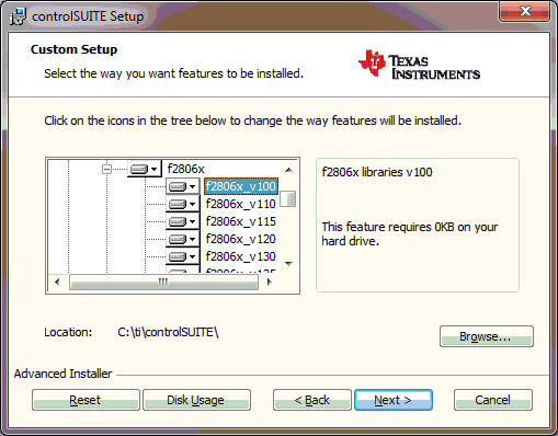

  • Which version of controlsuite is that?
    The one I installed from 15 Sept 2016 does not have v100a, only v100, and that example does not have that pdf in the doc folder.
  • Ben,
    That doesn't sound correct, maybe something odd happened during installation. The F2806x Flash API v100a was added in v3.3.3 on June 19, 2015 so it is in any newer version. Additionally, there is a doc in the v100 flash API directory.
    Best Regards
    Chris

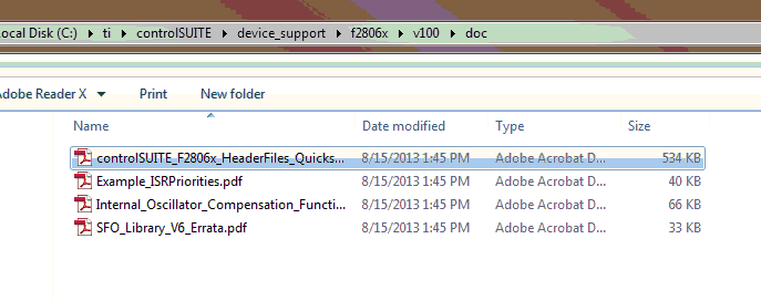

  • Yeah, no on both counts.
    v100 does not have the same file.
    These files do not discuss flash programming.
    Just downloaded the current version from ti.com.
    v100a is not in that package, either.
    If you have the file, then what does the return code of 0x1E mean?
  • Ben,
    You are looking in the device_support directory instead of the libs directory. This isn't under the device_support directory, in the root directory of controlSUITE, go to libs->utilities->flash_api->2806x and you will find the files I've described.
    Best Regards
    Chris
