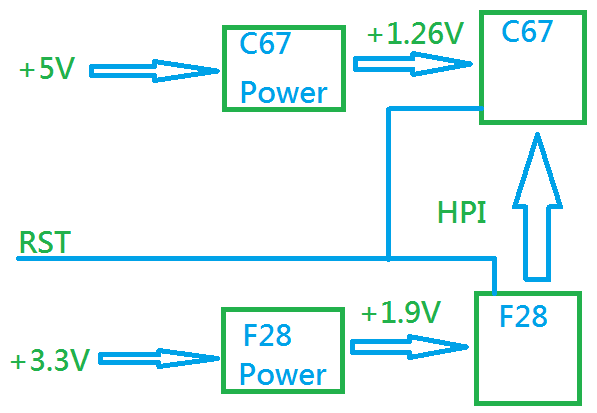

Hi ,
My customer's F2812 halt , and cannot have any idea what reason cause.
The GPIOD6 normally should be high when reset ,but it was low during reset timing when fail situation. (GPIOD6 default input/pull up when reset )
And XCLKOUT output is 37.5MHZ normally, but XCLKOUT is 3.75MHZ when fail.
Press reset-button also cannot reset the MCU.
Does anyone can give suggestions?

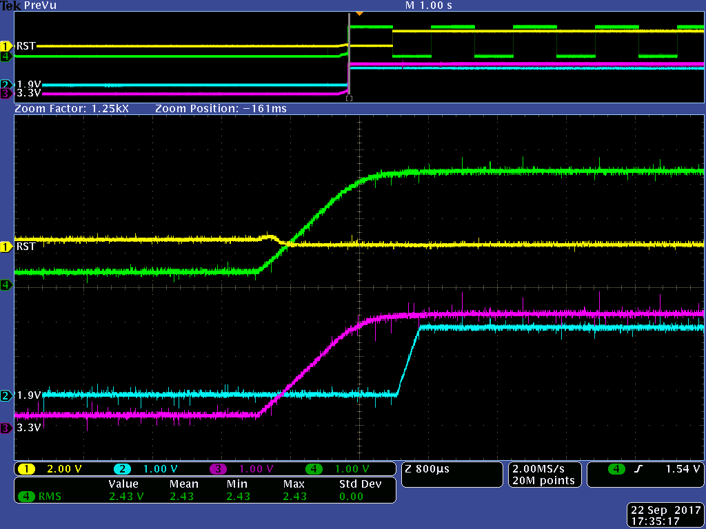

successful situation:
ch1(yellow): XRS pin , ch2(blue): 1.9V ,ch3(pink): 3.3V ,ch1(green): GPIOD6 ,
GPIOD6 is High during reset timing. And toggle well after reset.

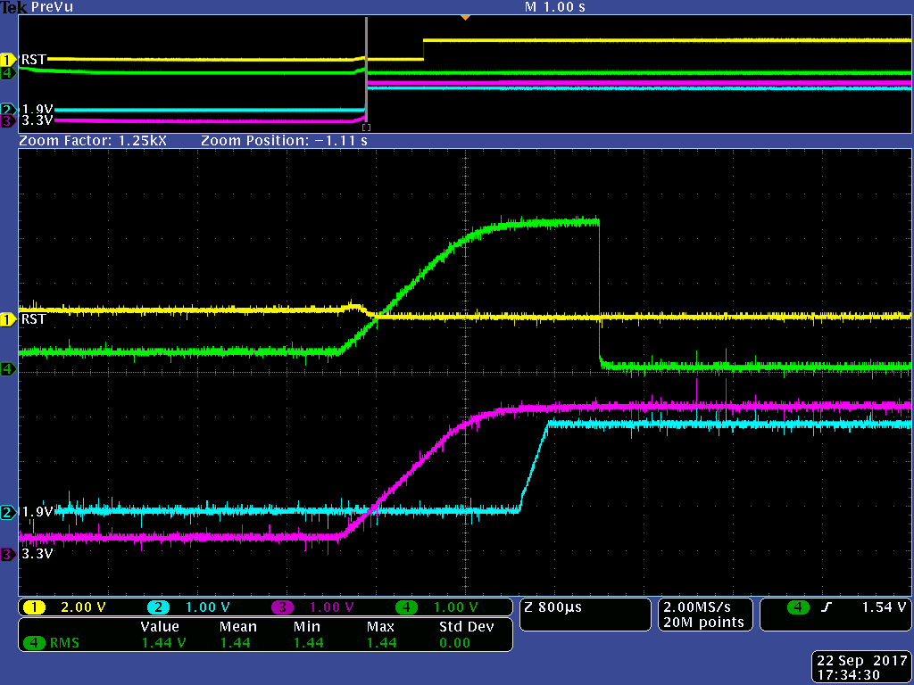

fail situation:
GPIOD6 is LOW during reset timing. And always low after reset.

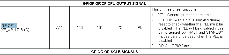

Are you using a clock input of 30MHz? If so, it looks like the PLL may have been cleared to it's default value.
Can you remove the external input from GPIOD6 and see the the behavior continues?
Finally are you using GPIOF14 for anything? Please see number 2 in the Datasheet excerpt shown below.
