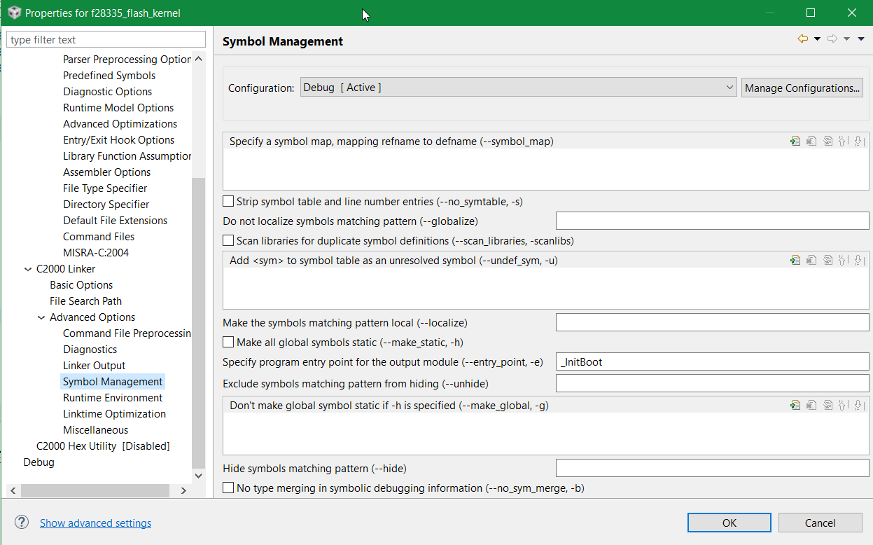

  • Hi Louis,
    Please add this to your flash kernel project properties... See the attached.
    Let me know if this solves your problem. It appeared to me that the kernel was not exiting properly and branching properly to the flash application which gets programmed by the kernel.
    sal
  • Issue still exists
  • Louis,
    Can you load the Kernel now with the above fix to RAM via CCS debugger and run that, please? While that is running execute the serial flash programmer with the code to load the kernel commented out. Can you see if the kernel is able to properly flash and branch to the application? Set a breakpoint at that the return from main and see if the code then branches to the entry address of the flash appliction, please.
    sal
  • Please use the attached file for the serial flash programmer.
    It appears there was another bug in the serial flash programmer which was not seen on other devices. It might not be a bug technically, but related to the synchronization between the f28335 and the PC which is not seen with other devices.
    sal
