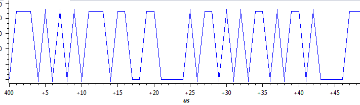

I have a problem with my EPwm signal, or maybe it is the problem with my ADC? I am new in this stuff and it is hard to tell for me what I am doing wrong. First I just wanted to start EPwm in any configuration and it looked like it worked, I used it to control brightness of a diode. But then I wanted to check how it actually looks so I connected it with a wire with Adc to see its trajectory in CCS Debug mode. This is what i got:
I dont think this is a good result, I belive it should be perfectly steady, meanwhile what i got looks like a total chaos, when i refresh the results it sometimes gets even wierder,
Here are the properties of the graph in CCS:
And here is my code:

  • Hi Wojciech,
    If I understand correctly, the ADC is triggered every 4096 cycles and the sampled ePWM has a period of 5000 cycles, so you are basically getting the beat frequency between the two similar periods. Try having the ADC sampling period << the period of the sampled ePWM. Maybe try something like every 50 cycles so you consistently get 10 samples per ePWM period?
