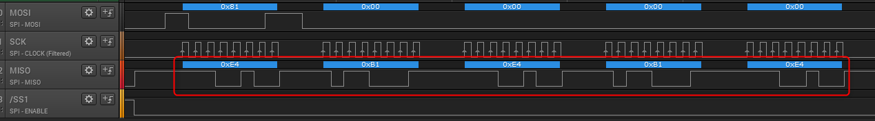

Hi.  I'm having a problem using the McBSP in SPI mode using DMA.  The receive side works fine, but the output data is transmitting one bit late.  For instance, when I try to transmit test data of 0x0022 0x0044 0x0088..., it appears on the wire as 0x0011 0x0022 0x0044...
Please see below for the relevant code.  I've ensured that the XDATDLY field of XCR2 is set to 0, so there shouldn't be any delay after the chip select (aka frame sync).  I've also played with the polarity of the clock signal (McbspaRegs.PCR.bit.CLKXP) to no avail.  Changing the stop mode (McbspaRegs.SPCR1.bit.CLKSTP) from 2 to 3 breaks the receive side, so I'm pretty sure I have that correct.
Any thoughts on what I'm doing wrong?  Most of this code is copied/modified from the example code available at C:\ti\controlSUITE\device_support\f2806x\v151\F2806x_examples_ccsv5, either mcbsp_spi_loopback or mcbsp_loopback_dma.
Alex

  • Thanks for the reply, Mark.
    By non-sequential data, I'm assuming you mean use a fixed but "random" test string, correct? If I try to send 0x95A6 0x5643 0x0000 ..., I actually get 0xCAD3 0x2B21 0x8000... So, _most_ of the bits are right-shifted by one, but the first bit is either corrupted or repeating.
    I'll give the non-DMA approach a shot, I have not yet tried that.
    -Alex
  • Mark-
    I disabled DMA as you suggested, and I'm still having the same problem.  I added a line of code at the end of initialization saying "McbspaRegs.DXR1.all = 0x66AA;".  No other writes to DXR1 occur, but the data I see on the output is 0x3355, repeating as often as the master supplies the clock.  If I run the code inside the debugger, I still see 0x66AA in the DXR1 register.
    I'm convinced now that the first bit is repeating, as though the first clock transition isn't being honored.  See the following images, for examples.  The data written to DXR1 is 0x66AA in the first image, 0xC963 in the second one.
    -Alex
  • Alex,
    So you might want to confirm your clock configuration once more. Your current settings are actually not a valid config. Check out Table 15-15. Effects of CLKSTP, CLKXP, and CLKRP on the Clock Scheme in SPRUH18 for the list of all possible configurations.
    -Mark
  • Thanks, Mark. I was going off of table 15-17, which is less restrictive. That was silly of me, but unfortunately not the (only) problem. I just re-confirmed that when I run as CLKSTP = 10b, CLKXP = 1, CLKRP = 0 I'm still having the same issue.
    -Alex
  • Hmm, I was hoping that would be it! Now that you have a proper configuration, have you confirmed that this is the matching config as your master? Judging by the capture you shared, the clock coming from the master is inactive low, and the SIMO is changing on the rising edge. What edge will the master sample the SOMI data on? I think the rising edge.
    I think you want the CLKSTP = 3, CLKXP = 0, CLKRP=1. This matches Figure 15-38. It also matches up with the images you shared.
    Mark
  • That fixed it. Thanks very much, Mark, I really appreciate it. I could have sworn I tried that before asking for help, but I guess I was mistaken.
    Thanks again,
    Alex
