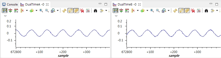

    At first, I have tried verifying current feedback with Lab01b.
    current waveform is captured via datalog module, my board have 2 current feedback (V, W)
     datalog.iptr[0] = &gAdcData.I.value[0]; // V current
     datalog.iptr[1] = &gAdcData.I.value[1]; // W current
    it is captured for gMotorVars.SpeedRef_krpm = 1.8 krpm
    my modification for user.h is as follows (I leave verifying voltage feedback for lab1c at this moment)
    #define USER_IQ_FULL_SCALE_CURRENT_A          (14.9058)
    #define USER_ADC_FULL_SCALE_CURRENT_A        (39.66)
    #define USER_NUM_CURRENT_SENSORS            (2)
    #define I_A_offset (1.333306)
    #define I_B_offset (1.333306)
    #define I_C_offset (1.333306)
    I have tested for 0.3 ~ 1.8 krpm, no overcurrent happened, motor runs smoothly, looks OK.
    but measured current is too small, no load current of motor is 2A, but it shows around 400mA (rms) from Osciloscope.
    my question for this step is what could limit current than proper value.
    please let me know your insight.
    Hae Ryong

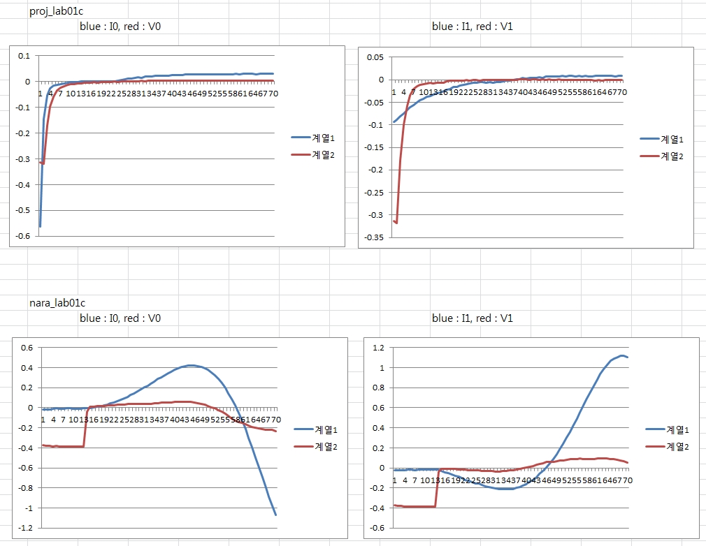

  • would you please take a look at following capture ?
    I have got 70 samples of phase current and voltage from starting motor with CCS debugger, and draw graph with them.
    upper 2 graphs are  captured from TMDSHVMTRKIT with reference motor, looks OK.
    lower 2 graphs are from my custom board.
    as you may see, PID make current and voltage to be stable state in upper graph, but current is rapidly increased in lower graph just within 70 samples and cause IPM fault soon.
    what could make this situation?  PID seems not working correctly.
    please let me know what need to be investigated.
    Thanks in advance.
