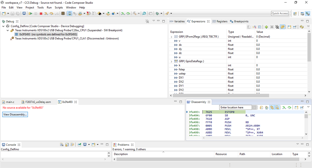

CCS/TMS320F28377S: No source available for "0x3fe493"
Part Number: TMS320F28377S
Hello!
I have been developing a code using the LaunchPad-F28377S with Code Composer Studio v. 7.1.0 and now I am stuck in this problem. I searched in the forums and found similar threads with the same issue, which were helpful, as these in the links:

Part Number: LAUNCHXL-F28377S We tried to flash the program in the kit. It gets flashed and all ready to be executed. But we get an error 'No source available for
However, I still don't know how to solve it and now i'm stuck. As pointed in these threads, it seems to be something related to ITRAP ISR and BOOT ROM.

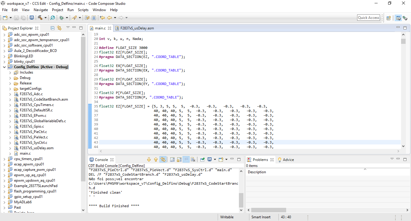

The problem happens after I add much data into the code and do the debug. I need to add lots coordinates in float format and also strings in char format. When I test with fewer data, the program runs normally in the debug, but after adding higher quantity of these data, the problem occurs and I can't do the debug.
Please, could you help me to solve this? I have a little time to finish this project.
I have done the process of defining _FLASH and adding memcpy to load the code from Flash.

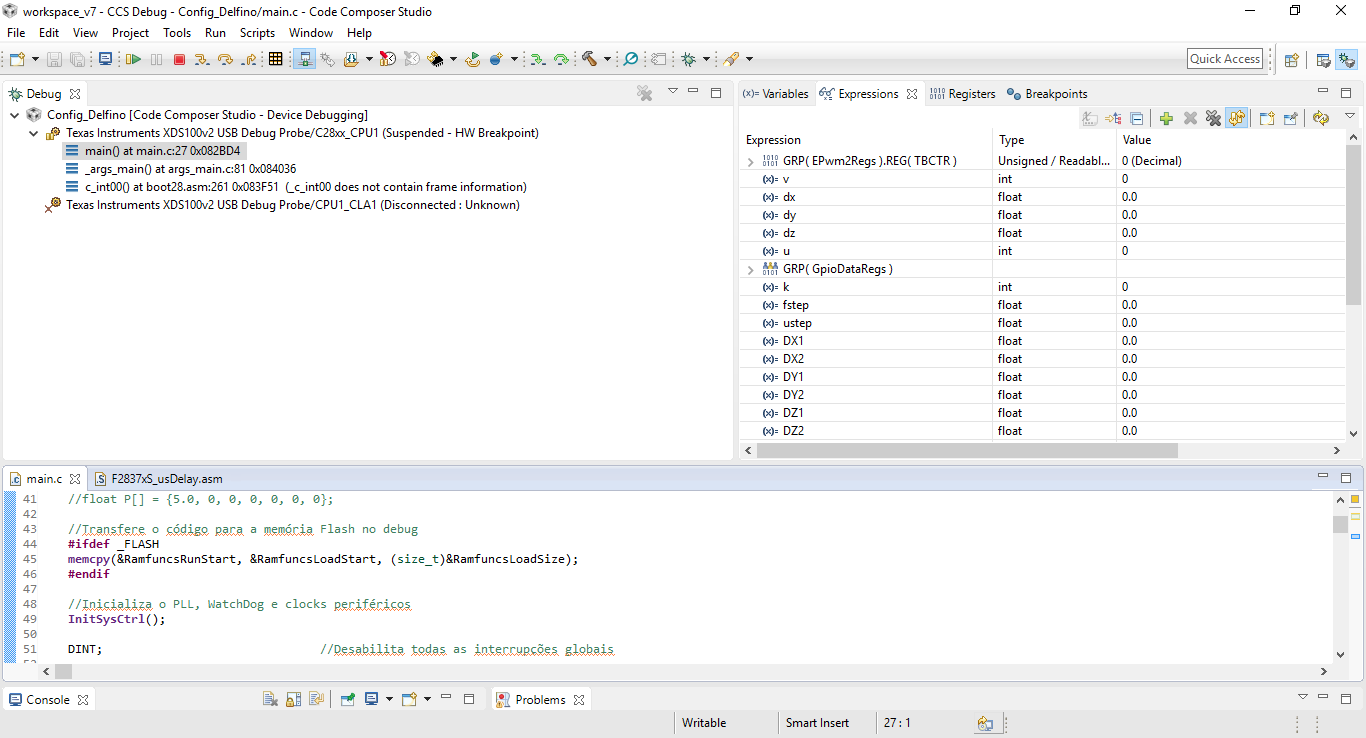

As I mentioned, everything runs fine until much data is added. I inserted 4 pictures that show what happens in sequence.

    When I say that I mean by adding much of the strings and coordinates in float format that I have to work with. It's the "GCODE", "EZ" and "EX" which can be seen in the picture I am attaching now.
    The program runs normally if there isn't a large quantity of these entries, but if there is some more of them, that problem occurs.

    I have been successful using 485 values in total, with them divided between "GCODE", "EX", EY", "EZ" and "P" that are the 5 buffers I need.

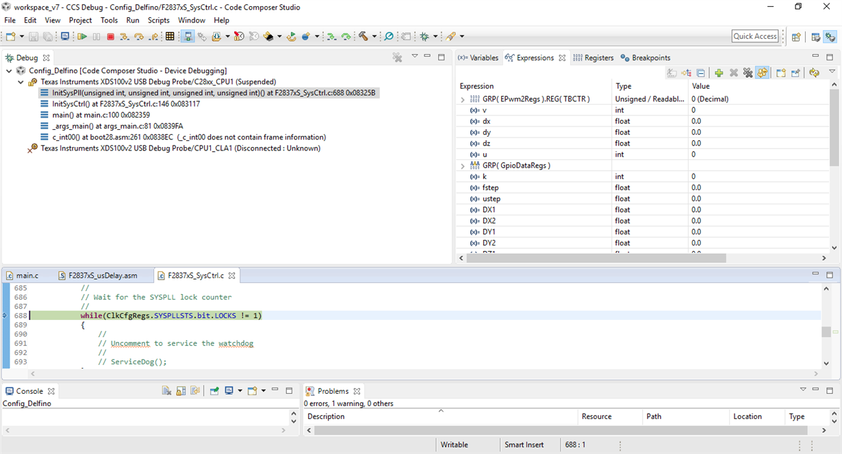

    If I try 486 entries in total, it breaks and then there comes the SysCtrl tab seen in the picture:
    If I try just a few more, the SysCtrl tab doesn't appear, but the No source problem comes up:
  • Taumer, I see I can define the size of my char array "GCODE" to about 1900 with "char *GCODE[1900]" and increase the number of values I can add to it, which is what I need. That way, I can debug and run the program normally.
    But I also need increase the 4 float buffers and I can't do the same. If I try to define some value and add more entries, I receive the No source available problem again.

  •   Hi Taumer!
    This solution worked for me! I have done the proceedings in that post and inicially I could increase the GCODE defined value much over 2000, which was almost the limit before and I wouldn't take the "Program will not fit into available memory" anymore.
    But I was still receiving the "No source available" problem for the float format arrays. They were inside the "main()", then I passed them out of it and now it works, the program runs normally again with higher values I need for the arrays!
    I'm inserting the pictures just to show what I have done.
    I have put the "RAMGS" origin address equal the commented RAMGS6, because I was receiving errors telling there were other archives from RAMGS0 to RAMGS5. I also changed the ".ebss" and the float arrays allocated as ".COORD_TABLE" to "RAMGS" in the SECTIONS part.
