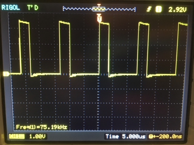

Hi everyone,
I'm encountering a problem with HRPWM similar to the one mentioned in this topic. I have seen it occur both on TMS320F28035 (ePWM Type 1) and TMS320F28075 (ePwm Type 4).
The problem manifests itself as an unwanted glitch on the PWM output. In the actual application I use many peripherals such as the ADC, ECAP, ECAN, SPI, CPU timers and interrupts, CLA, etc. but I took some time to find the smallest possible code which allows me to reproduce the problem, which seems to only involve the ePWM peripherals.
The oscilloscope screenshot below shows the glitch. It is achieved with a small program running on the TMS320F28035 controlCARD.
The yellow signal is EPWM1A on GPIO0. The blue signal is a reference signal generated using EPWM2A with edges configured for events CTR=PRD and CTR=ZRO.
First a few notes on things I have tried:
  • The ePWM period (TBPRD) and clock speed (TBCTL[CLKDIV] and TBCTL[HSPCLKDIV]) do not seem to have any influence on the problem.
  • I have tried with and without using the autoconversion feature, it doesn't seem to change anything to the problem.
  • I have tried with and without the background calibration of the MEP using the SFO() function and doesn't seem to change anything to the problem.
  • I have tried using the internal oscillator and an external quartz but it doesn't change anything to the problem.

All this program does is switch CMPAHR between zero and a non-zero value.
The problem only seems to appear when the ePWM is running in up-down count (TBCTL[CTRMODE] = 2) AND the micro-edge position logic controls the falling edge (HRCNFG[EDGMODE] = 2) AND the CMPAHR load event is programmed outside of the pulse (when the PWM signal is at 0).
This last condition is because I have seen the problem in two configurations:
  1. Pulses centered on CTR=ZRO (AQCTLA[CAU] = 1 / AQCTLA[CAD] = 2 / HRCNFG[HRLOAD] = 1)
  2. Pulses centered on CTR=PRD (AQCTLA[CAU] = 2 / AQCTLA[CAD] = 1 / HRCNFG[HRLOAD] = 0)
Furthermore the width of the glitch seems to be related to the value of CMPAHR, as shown by the two pictures below. The first one is with CMPAHR set to 130 steps and the second one with CMPAHR set to 230 steps.
That is all the information I have for now, but if you need to know anything else please let me know.

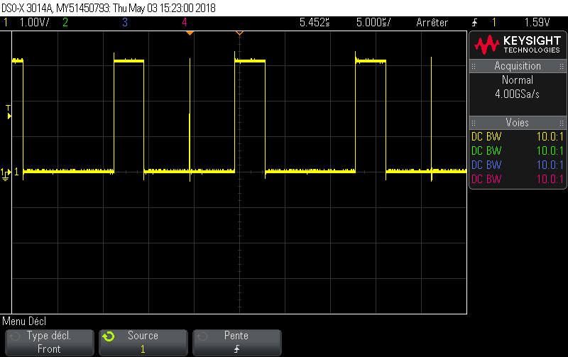

  • Nima,
    1. I cannot find any example codes with the HRPWM used for duty control in up-down count mode. Where are they?
    2. Please find attached a small CCS project with all the features you asked: AUTOCONV, SFO and all unused events set to zero (no action) as you asked.
    3. You can see in the oscilloscope capture that the anomaly is still present. HRPWM_GLITCH_2.zip
    Cheers,
    Pierre

    I have also take out the AUTOCON to show how the issue is caused by not using AUTOCONV nor the MEP_SFO library.

  • Hello Pierre,
    I just went through this post and I believe I have an explanation and a solution (although you've already found/implemented it).
    The key piece in your configuration is that HR edge control is only applied to the falling edge (EDGMODE = 2).
    When AQ settings 'Set' the output on a CAD match and reset the outputs on a 'CAU' match, the falling edge occurs when the counter is counting up. As a result the HRLOAD should be configured to load on 0. I would also select LOADAMODE = 0 to keep all values synchronized for that cycle, but this is not a necessary condition.
    Similarly, when AQ settings 'Set' the output on a CAU match and reset the outputs on a 'CAD' match, the falling edge occurs when the counter is counting down. As a result the HRLOAD should be configured to load on PRD. LOADAMODE could be PRD or 0 based on your control requirements.
    HRLOAD should be selected to load on both 0 or PRD, when HR edge control is applied to both rising and falling edges (EDGMODE = 3).
    I hope this helps.
    Hrishi
  • Hello Hrishi,
    Indeed I try to keep the values synchronized because it seems logical to have CMPA and CMPAHR updated at the same time.
    However in this case it's precisely how the anomaly appears: as soon as I try to synchronize the values it shows up.
    The workaround I have been applying, i.e not synchronizing the values, allows me to have something that works. The update of CMPA needs to occur before the next rising edge whereas the update of CMPAHR only needs to occur before the next falling edge.
    I still have no idea why the anomaly occurs but I think your message is a confirmation that my workaround should be effective. Could you take a look at the diagram attached to this message and confirm my understanding is correct?
