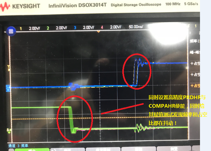

Hi Champs,
In my customer's application, high resolution period and high resolution duty cycle will be used simultaneously. And they found there were some jitter on the ePWMxA's output.
You can see the scope capture as follows. The yellow waveform is ePWM1A output, and the blue one is ePWM3A output.
And also, if EPwm1Regs.HRPCTL.bit.HRPE was set to zero, the jitter will be gone.
So the question is whether high resolution period and high resolution duty cycle can be used simultaneously?
Thanks.
Young

  • Hi Nima,
    Customer revise the code accordingly, but the issue still exists. Would you kindly help to review the code as follows?

  • Found the issue. In  the HRPWM config function the code was not setting EDGEMODE to both edges. In the comment, it said "both edges" however in the customer code you sent me, the value used was "2". If you change that to "3" which is both edges as mentioned in the TRM, you see that the jitter will disappear.
    So here is what I changed in the code:
