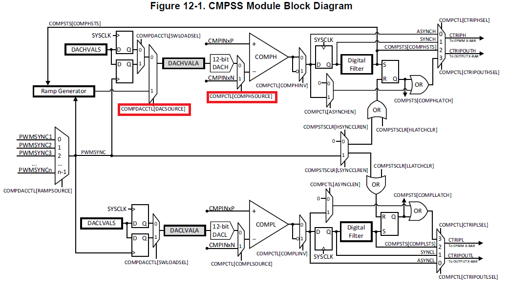

how can i use the ramp generator in cmpss to work instead of the dacvala register?
is there a way such that i can use the digital filter in cmpss code  for the giving the ramp generation
in the pre-existing code for cmpss digital filter -

c
there is no inclusion of any code for choosing the the source of compH_n from dac or ramp generator
COMPDACCTL.bit.DACSOURCE = 1;  //for selecting the ramp generator as a source
  • Hi Surya,
    All the information you are looking for is indicated on the CMPSS block diagram. If a connection is not indicated on the block diagram, then it can't be done. Below is the CMPSS block diagram. The highlighted areas show the registers you need to change to use the ramp generator with comph. Ramp generator is not available for compl.
    No, the digital filter cannot generate the ramp. The connection you see going from the digital filter to the ramp generator is used for synchronization purposes.
  • from the above i'm making these inferences .
    1)for a comph ,i can use the ramp generator , in tandem with the synch / asynch mode (instead of digital filter)
    2)and can i use this part of syntax to change the connection from the dacvals torampgen as the o/p
  • 1)for a comph ,i can use the ramp generator , in tandem with the synch / asynch mode (instead of digital filter)
    Yes but only sync and filter only and not asynch.
    Yes.
