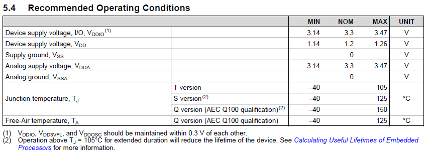

    Generally speaking, you can use any power supply for TMS320F28375S as long as the power source satisfies the following three aspects:
    1) Recommended Operating Conditions
    2) Power Capacity
    3) Power Sequencing
    Looking at the TPS70345 datasheet, it appears that this dual output LDO can satisfy all three aspects of voltage range, power capacity, and ramp sequence (SEQ=0).

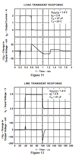

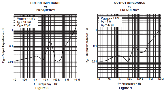

    Thank you so much for detailed explanation and support. I have a doubt in TP70345 datasheet. As i understand it is a fixed dual output LDO with 3.3V & 1.2V. Below figure is from datasheet.
    But in graphs, it shows that it generates an output of 1.8V instead of 1.2V. It made me confused while referring the data. Below figure is for quick reference.
    Could you please explain why is it 1.8V.

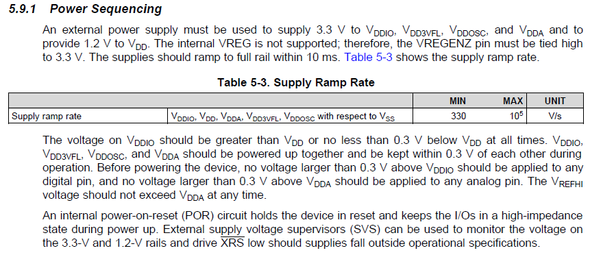

    One last question, Is there any power on and power sequence for TMS320F2837XS. As I understand it is mentioned only about voltage level to be maintained. But are there any specific timing consideration like which supply to be ON first while powering ON, What is time gap to be maintained between two power supplies.

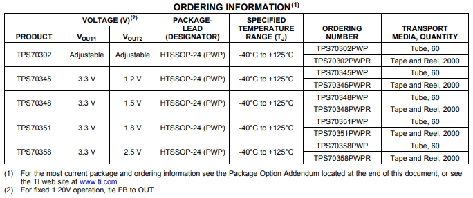

    I believe that you are looking at the enhanced, high-reliability (EP) version of the TPS70345 device.  Information in EP datasheets is often sourced from the non-enhanced versions of the devices.
    The TPS703xx datasheet has multiple device offerings with various fixed output voltages:
    The power sequencing requirement from the F2837x datasheet recommends that the 3.3V supply always be greater than the 1.2V supply.  This condition is most easily satisfied by powering on 3.3V before 1.2V.  There is no dead time requirement.
