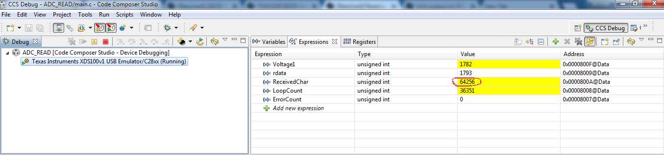

I am using a F2812 based experiment kit. One of my project goals is to send the data obtained from ADC to a mobile app using bluetooth. So the first thing, i am trying, is using the SCI_loopback example code to check that i am receiving  the exact value that i am sending. Here the ADC data is 16 bit (after 4 bit shifting) but SCI can send 8 bit data. So for getting the 16 bit data i have used some of the suggestions given by you in other posts. Now the code i am using is the following :

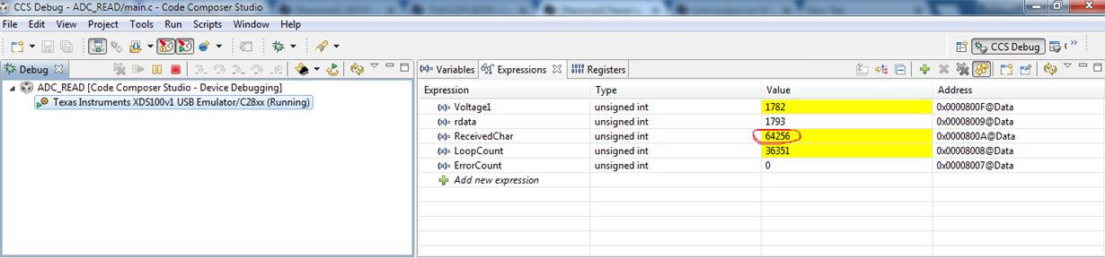

but using this code the data i am receiving via SCI is totally different from the sending data. I am sending the data in a variable called Voltage1 and receiving the data via SCI in a variable called ReceivedChar. But the value of this two variables are totally different. A screenshot of the "Watch Expression" window is attached below. Here i am keeping the Voltage1 constant ( value of Voltage1  is always around 1782).

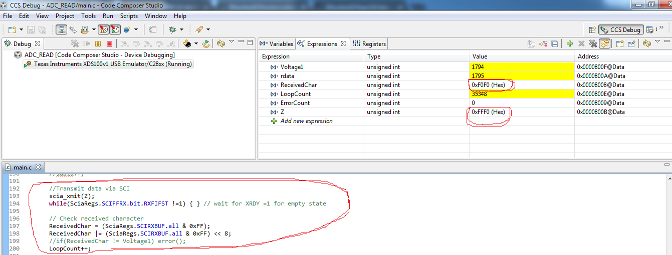

  • Thanks for your help. I have modified the code as suggested and now i am able to send and read 16 bit data via SCI. But  while reading the 16 bit data it is not same as the send data. When i am sending 0xFFF0 then i am reading the value as 0xF0F0. In the following code i am sending the data in Z and reading the data in ReceivedChar.
  • When i am sending 2 byte via SCI then while reading i am getting the last byte 2 times.

  • Supratim,
    It looks the problem is with the second line of code (from your previous post):
    // Check received character
    ReceivedChar = (SciaRegs.SCIRXBUF.all & 0xFF);
    ReceivedChar = (SciaRegs.SCIRXBUF.all & 0xFF) << 8;
    You are writing over ReceivedChar. Try using a 'LowReceivedChar' and 'HighReceivedChar' and then logically OR them.
    I hope this helps. If this answers your question, please click the green "Verified Answer" button. Thanks.
    - Ken
  • Hi Supratim ,
    The issue seems to be that you are reading the same LSB data twice in 2 different forms.
    You are not receiving the MSB but are reading the LSB again.
    Please wait for the next  incoming character and then read it .
