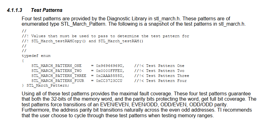

I am using march13n test from C2000Ware_1_00_01_00,
I am trying to understand the affect of test patterns on the coverage and if i need to run the test with all four patterns,
i found this:
from C2000 CPU Memory Built-In Self-Test spracb9.pdf.
This seems to indicate i need to run all four patterns, this would make quadruple the time it will take me to finish a complete run of the test,
Please explain the need why we need these patterns..

  • Hi Krishna,
    Thank you for your answer,
    I meant something a little different from what you answered,
    i will try asking it from another angle,
    if i use only one RAM Test Pattern - will it be enough to detect all possible ECC and Parity errors?
    Thank you,
    Peter Berger
  • Hi Peter,
    To clarify all four test patterns are provided to get maximum coverage for worst case speed paths.
    To answer your questions, you only need to use one pattern. Executing the march algorithm with any of these provided test patterns will provide you will 100% stuck-at-bit (SA) coverage of the RAM being tested including the data and EDAC bits.
    You do not need to use all 4 test patterns. One will test for all stuck-at-bits. We provide the 4 different test patterns to aid in testing worst case speed paths of the RAM bit cells. This isn't required, but is additional.
