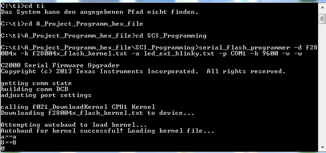

While using the serial flash programmer I encountered a problem loading the kernel file onto the ram. After two hex digits the download on the HW stops as seen in the picture. Does anyone know what to do about it ?
  • Hi Patrick,
    Windows sometimes appends some characters to the top of txt files when you open them in a text editor. Did you happen to do this?
    Can you try freshly building the .txt and merely copy and paste it to the place you need it? or better yet, just point to the build directory from the command line?
    If that does not solve it, then I think you will need to load the SCI bootloader symbols from the boot ROM to debug further.
    You also may be able use a slower baud rate and see if that helps.

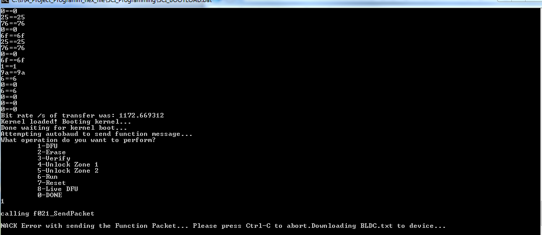

    thanks for your reply, unfortunately after I resolved the issue with the kernel file I encountered another Problem.
    I followed your instructions and recompiled the kernel file. I am now able to download the kernel file onto the ram. Now I tried to load an application file onto the devices flash with the use of option 1-DFU. The application returns a NACK Error (see picture below). Is there someting that I did wrong ? I already lowered the baud rate but that didnt help.

  • Hi Patrick,

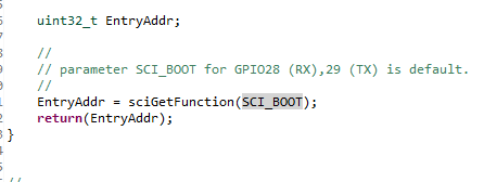

    Please make sure the kernel is compiled using the proper GPIOs. There should be a parameter for this to a function call. It is either SCI_BOOT or SCI_BOOT_ALTERNATE.
    Are you using the proper GPIOs in the kernel? the same you are using in the bootloader?
    sal
  • Hi Sal,
    we are using the standars sci pin configuration GPIO28, and 29.
    I assume you meant this section in the code. I already compiled the kernel file in that configuration.
