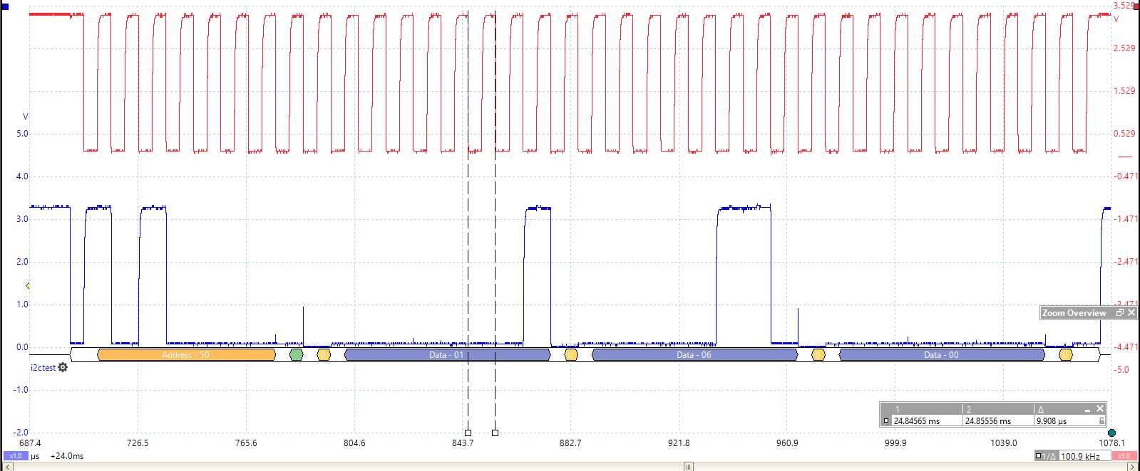

I am using I2c on core 1 which are GPIO 104 and GPIO 105.
If I get a Nack from slave my clock goes low.
1)Is there a register to look for Nack?
2) Is there a way I can reset my I2C module once I see this Nack register and how can it be donr to restart the i2c communication?

    Whenever I do reset my i2c module then my clock frequency reduces from 100 khz to 6 khz. Why is that happening? When I first compile and execute the code the same clock registers make the clock running at 100 Khz but after reset or reset(in CCS)  it goes low to 6 Khz.
  • 1)
    After compiling with same clock registers as mentioned before i2c runs at 100 Khz
    2) After i2c module is reset via IRS register or reset in CCS
    results in clock frequency at 6 khz
  • Hi Sagar,
    You cannot write to some of those register bits (such as I2CPSC) while the I2C module is out of reset (IRS = 1). You should take the I2C out of reset after I2CPSC, I2CCLKL, I2CCLKH, & I2CIER have all been initialized in your code, similar to what's in the i2c_eeprom example within c2000ware.
    Hopefully that fixes your issue!
