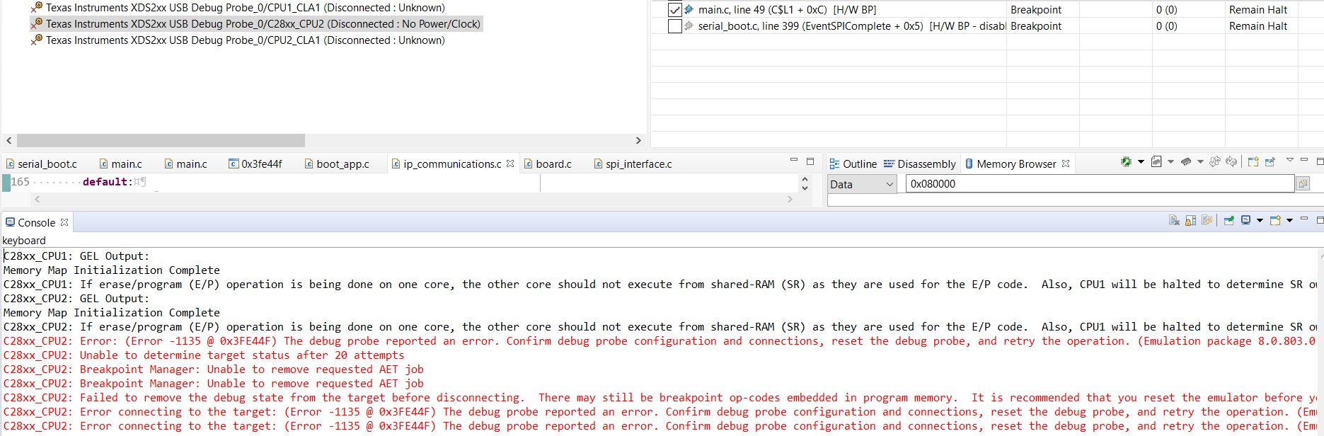

    I have tried to debug the bootloader. I was connected to both CPUs, CPU2 is in reset until CPU1 wakes it up. When CPUs reaches the IPC instructions to wake up CPU2, this is what I see:
