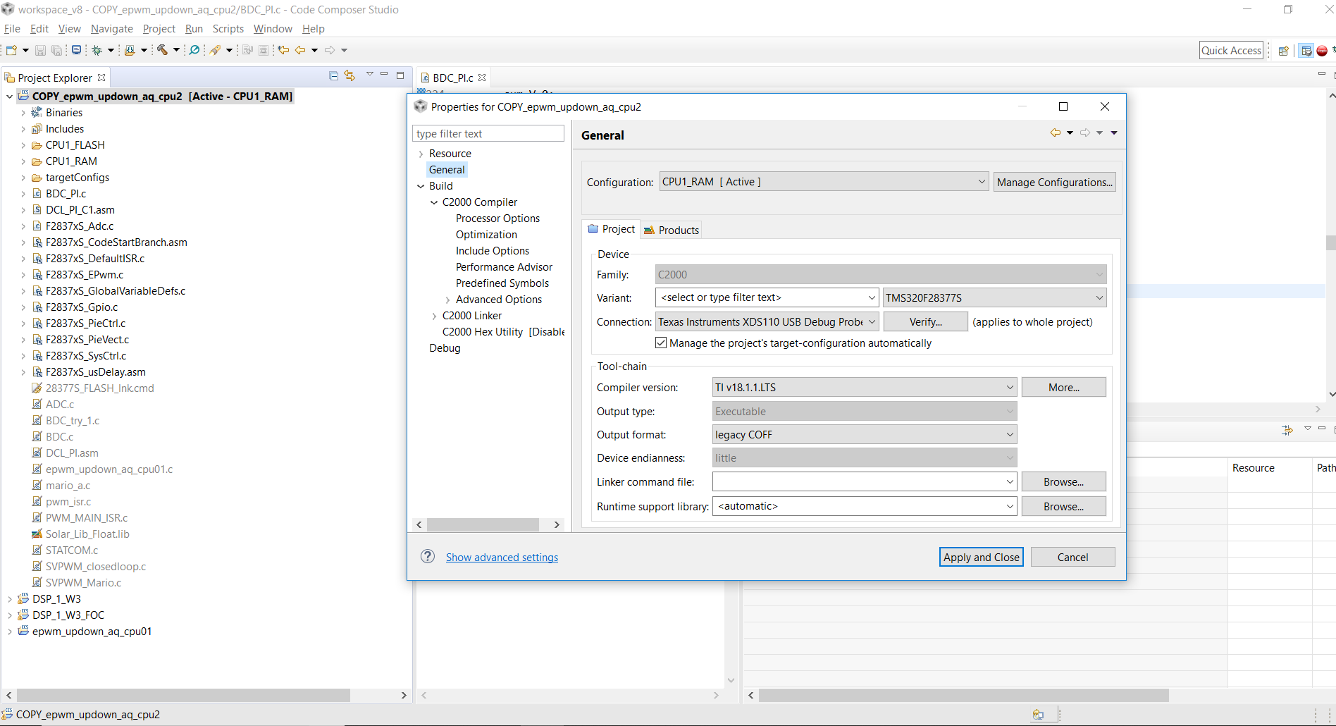

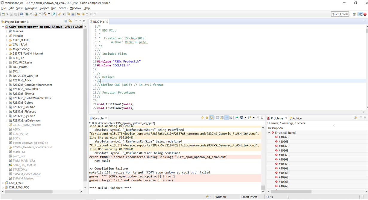

I am using PI controller for DC-DC converter control. When this line "  uk_V = DCL_runPI(&pi1, rk, yk); " is executed, the compiler jumps to illegal ISR. and when debugged says the error " cannot load from non-primitive location". Though all the variables ( uk, rk, yk) have same data type "float". The compiler also gives warning "warning #10247-D: creating output section "dclfuncs" without a SECTIONS "
Kindly Help.
Thanking you in advance.
  • I can tell from the function name you are using v1.0 of the library.  I recommend updating to the latest v3.0 which you can find in C2000Ware.  The equivalent function in the newer library is DCL_runPI_C1.
    The warning is telling you that there's no allocated memory for the controller.  You'll need to add a line to your linker command file to tell the linker where to place that section.  Something like:
    dclfuncs : > RAML4, PAGE = 0
    The newer library has several working examples, so it may help to look through those to see how this is done.
    Possibly the "non-primitive" error has to do with the above, but check also that you have declared your "pi1" controller structure correctly and that it is visible to the function.
    Richard

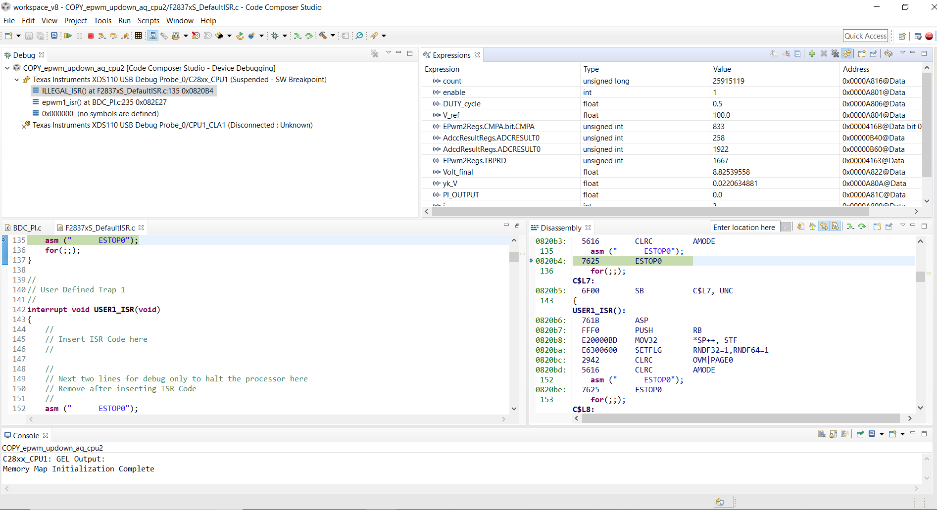

  • Hey Richard,
    As you suggested I updated the latest version v3.0. But it doesn't work for me. To remove the warning I included command in linker file. But it gives me the error as attached in the image. But, I don't find any other linker command file, then why it gives me error of "more than one linker command file".  Regarding, Non-primitive location, I have defined them correctly. but For you to look into it, I am attaching my program.
    Thanking you for your support.
    Vidhi

  • Hi Vidhi,
    Your code is actually building without errors or warnings for me. Regarding the symbol re-definition error you're seeing, it is because you have another linker command file being referenced somewhere in your project. I only see one in the project explorer window, but check your project properties (right-click on the project name, select "Properties...", and check in "CCS General") whether a different linker command file is specified there.
    Do you still get the same non-primitive warning when you debug as before? I'm not getting that at the moment.
    BTW, I don't think this will cause the error, but I did notice you don't have enough initializers in your declaration line of pi1 & pi2. check the DCLF32.h header file to see the DCL_PI structure elements.
    Richard
  • Hey Richard,
    The program doesn't give the error directly. Because first time when program runs "enable = 0" , so program does not move inside DCL_PI function (line 229 in code). Now, when I put enable = 1 in watch expression manually, after the program is building successfully, it will go inside loop and will jump to illegal ISR and stops at line 235 in code. Kindly have a look in image attached. Before, when I put cursor on the uk_V, in the value parameter it said "cannot load from non primitive location."  But now it shows in the value "0.00".
    Regarding, Linker command file, I checked in the properties but I do not find any other linker command file.
    Thanking you.
    Vidhi
  • Hi Vidhi,
    For the symbol re-definition error, those labels would be defining the addresses of functions you want to load into RAM.  They must be in more than one place in your project or the compiler would not generate the warning.  Can you do a search through your linker, source, and header files to check where they appear?  Normally they would be defined in the linker file, extern'ed in a header file, and referenced in a memcopy() function.  Check the flash example in the C2000Ware header files to see how this is done.
    Did you look at the last item in my previous post?  When I was stepping through your code afterwards I noticed the controller doesn't work unless you have the right number of initializers.  Please look at this again.  You should have ten initializers in PI_VALUES_I and PI_VALUES_V.
    Richard
  • Dear Richard,
    I am sorry to say but, I defined 10 parameters for PI_VALUES_V and PI_VALUES_I, and still its the same issue. If I use linker command file it still gives me error of duplicate allocation of memory. But, I go through source, header and linker files and I do not find linker files more than one. May I ask which linker command file are you using?  I tried using "2837xS_Generic_RAM_lnk.cmd"and also "28377S_RAM_lnk.cmd, but then also the errors.
    I think its the problem related to memory and not code.
    I noticed another thing when I try to debug that "where it stops and why" and, I found that it stops in file "DCL_PI_C1.asm" at line 28, as it do not find the value of R4H ( as seen in image attached) , R5H, R6H and jumps to illegal ISR. Kindly guide me that how to find these values and also if I have to give some address instead of "NULL_ADDR" in defining " PI_VALUES_V" and "PI_VALUES_I ".
    #define PI_VALUES_V { 1.0f, 0.0f, 0.0f, 1.0f, -1.0f, 1.0f, 1.0f, -1.0f, NULL_ADDR, NULL_ADDR}
    //#define PI_VALUES_V {0.06f, 0.1f, 0.1f, 1.0f, -1.0f, 0.1f} // Kp, Ki, i10, Sat_max, Sat_min, Sat_storage
    float rk_V;    // Reference value
    float yk_V;    // Measured ADC signal
    float uk_V;    // PI output
    //float lk_V;
    DCL_PI pi1 = PI_VALUES_V;
    float V_ref=100;
    int enable=0;
    // PI controller variables for current controller
    #define PI_VALUES_I { 1.0f, 0.0f, 0.0f, 1.0f, -1.0f, 1.0f, 1.0f, -1.0f, NULL_ADDR, NULL_ADDR}
    Thanking you,
    Vidhi
  • Hi Vidhi,
    To see R4H you will need to do View -> Registers, and open the FPU registers. ' R4H' will behave that way in the Expressions window.
    The instructions in the disassembly window are not those of the controller. I think we need to fix the .dclfuncs mapping in the linker command file. For reference, below is the linker file I'm using.
    MEMORY
    PAGE 0 :
    /* BEGIN is used for the "boot to SARAM" bootloader mode */
    BEGIN : origin = 0x000000, length = 0x000002
    RAMM0 : origin = 0x000122, length = 0x0002DE
    RAMD0 : origin = 0x00B000, length = 0x000800
    RAMLS0 : origin = 0x008000, length = 0x000800
    RAMLS1 : origin = 0x008800, length = 0x000800
    RAMLS2 : origin = 0x009000, length = 0x000800
    RAMLS3 : origin = 0x009800, length = 0x000800
    RAMLS4 : origin = 0x00A000, length = 0x000800
    RAMGS1415 : origin = 0x01A000, length = 0x002000
    FLASH_A : origin = 0x080002, length = 0x001FFE
    FLASH_BCDEFGHIJKLMN : origin = 0x082000, length = 0x03E000
    RESET : origin = 0x3FFFC0, length = 0x000002
    PAGE 1 :
    BOOT_RSVD : origin = 0x000002, length = 0x000120
    RAMM1 : origin = 0x000400, length = 0x000400
    RAMD1 : origin = 0x00B800, length = 0x000800
    RAMLS5 : origin = 0x00A800, length = 0x000800
    RAMGS0 : origin = 0x00C000, length = 0x001000
    RAMGS1 : origin = 0x00D000, length = 0x001000
    RAMGS2 : origin = 0x00E000, length = 0x001000
    RAMGS3 : origin = 0x00F000, length = 0x001000
    RAMGS4 : origin = 0x010000, length = 0x001000
    RAMGS5 : origin = 0x011000, length = 0x001000
    RAMGS6 : origin = 0x012000, length = 0x001000
    RAMGS7 : origin = 0x013000, length = 0x001000
    RAMGS8 : origin = 0x014000, length = 0x001000
    RAMGS9 : origin = 0x015000, length = 0x001000
    RAMGS10 : origin = 0x016000, length = 0x001000
    RAMGS11 : origin = 0x017000, length = 0x001000
    RAMGS12 : origin = 0x018000, length = 0x001000
    RAMGS13 : origin = 0x019000, length = 0x001000
    CPU2TOCPU1RAM : origin = 0x03F800, length = 0x000400
    CPU1TOCPU2RAM : origin = 0x03FC00, length = 0x000400
    SECTIONS
    codestart : > BEGIN, PAGE = 0
    ramfuncs : > RAMM0 PAGE = 0
    .text : >>RAMM0 | RAMD0 | RAMLS0 | RAMLS1 | RAMLS2 | RAMLS3 | RAMLS4, PAGE = 0
    .cinit : > RAMM0, PAGE = 0
    .pinit : > RAMM0, PAGE = 0
    .switch : > RAMM0, PAGE = 0
    .reset : > RESET, PAGE = 0, TYPE = DSECT /* not used, */
    .stack : > RAMM1, PAGE = 1
    .ebss : > RAMLS5, PAGE = 1
    .econst : > RAMLS5, PAGE = 1
    .esysmem : > RAMLS5, PAGE = 1
    dclfuncs : > RAMLS4, PAGE = 0
    ramgs0 : > RAMGS0, PAGE = 1
    ramgs1 : > RAMGS1, PAGE = 1
    IQmath : > RAMGS1415, PAGE = 0
    IQmathTables : > RAMGS1415, PAGE = 0
    The important thing is to map .dclfuncs somewhere which makes sense. From your screen-shot it looks like something is over-writing the code.
    Richard
  • Dear Richard,
    I try to see FPU registers and the value says "memory mapped".
    I imported the one of the examples to see if it works with that.  I flashed the code and it gives me the same error "#10263 and #10264". Now, I really don't get that how it finds two linker command file. Even your linker command file and other PCs gives me the same error.
    Guide me further.
    Thanking you !
    Vidhi
  • Vidhi
    Regarding your register window issue and errors, I suggest a couple items that may help:
    - Start a new workspace and load a simple C2000Ware example and see that your register window is behaving correctly
    - Check your project properities then under "Build->C2000 Linker->File Search Path" make sure no linker is listed there
    - Next step may be to create a new empty project and add in your necessary files
    Best regards
    Chris
