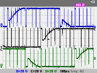

I tried changing the PWM frequency from 20Khz to 40Khz but it did not help(same results). Then i try further changing it to 60Khz when i run the code motor stuck on startup and supply reached to max current limit.
My adc isr frequency is 20Khz. when i change both adc isr and pwm frequency to 40 Khz motor does not run.

Yes, we are able to check the PWM output frequency on oscilloscope. I did not see any other option to change as the instaspin library source code is not available.
