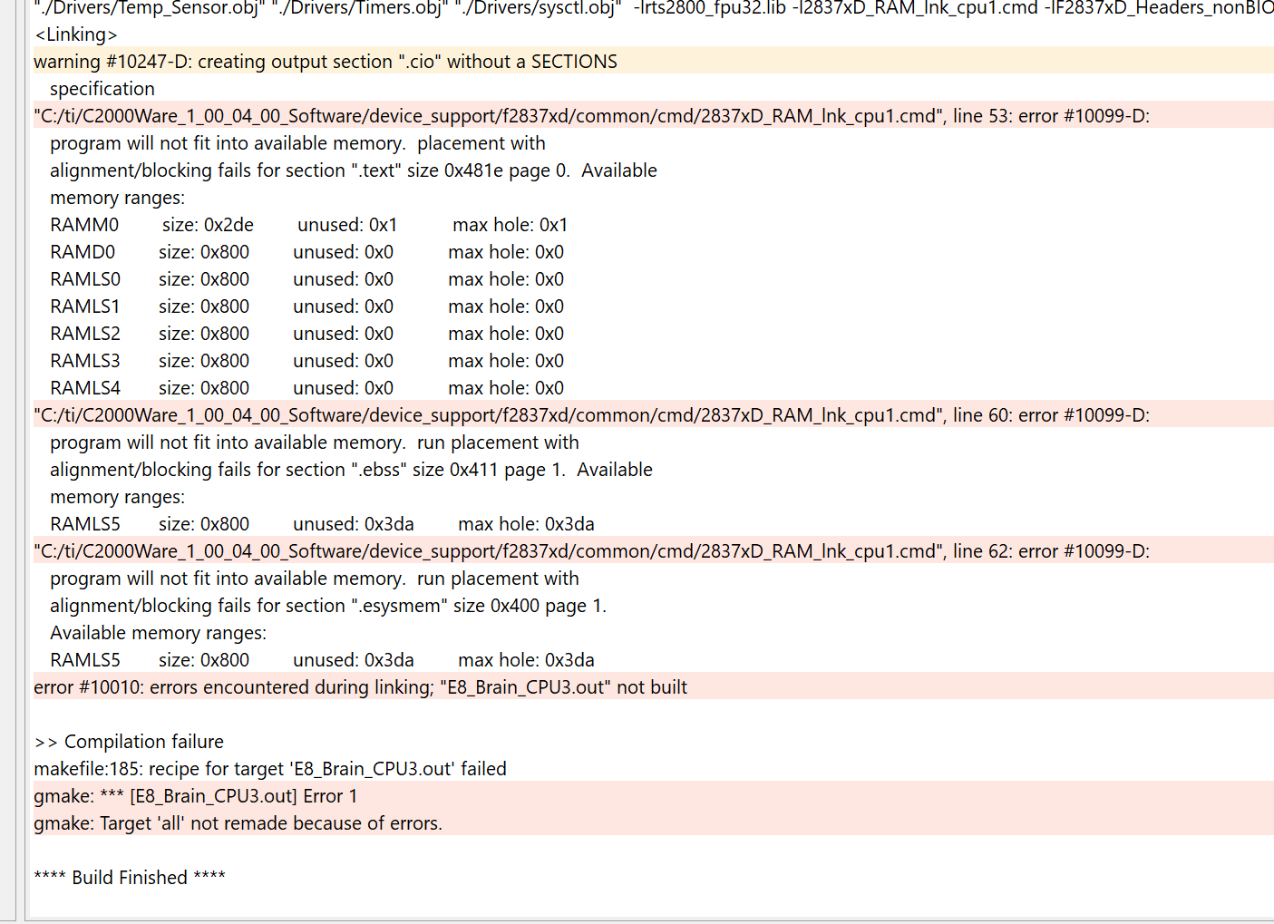

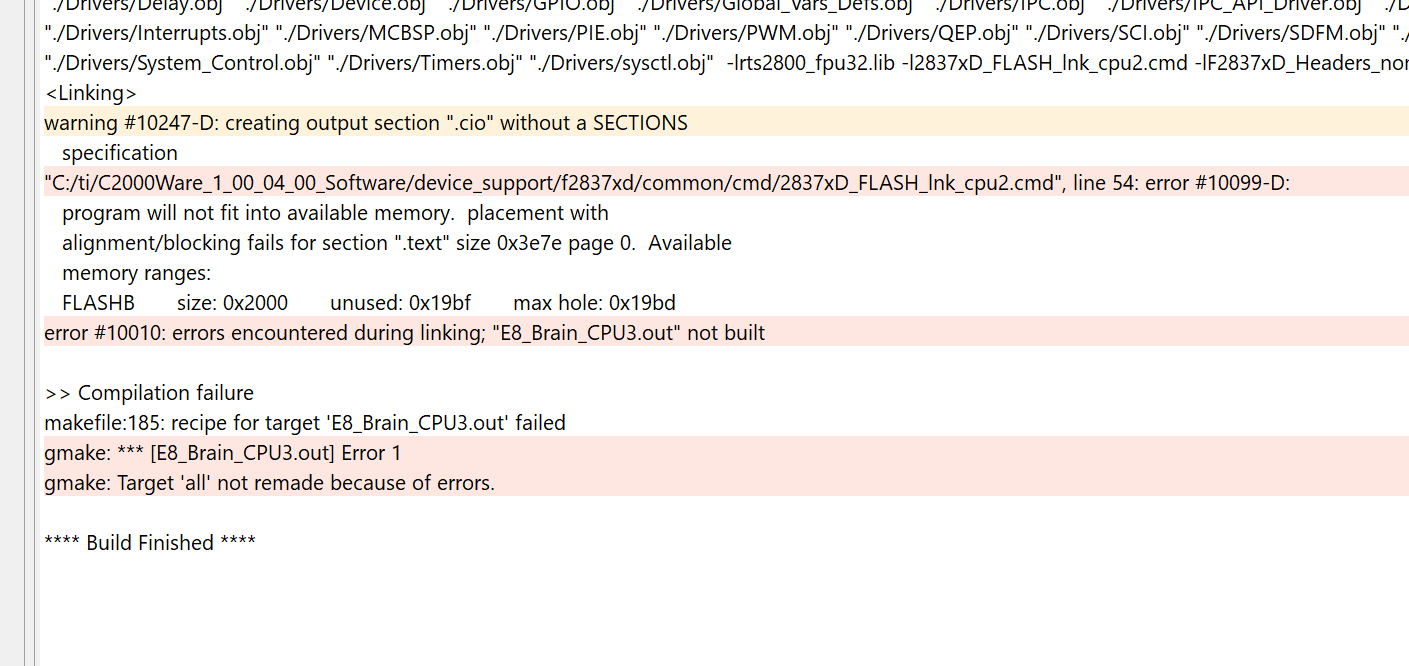

OK so I tried to upload the offending project into my cloud space CCS. I received the following error.
Just to be sure I am using the compiler version 18.9.0...
I dont understand why I would get this error.
Hopefully if I can load this into the cloud you will be able to get access to it ans help me solve some of the problems.

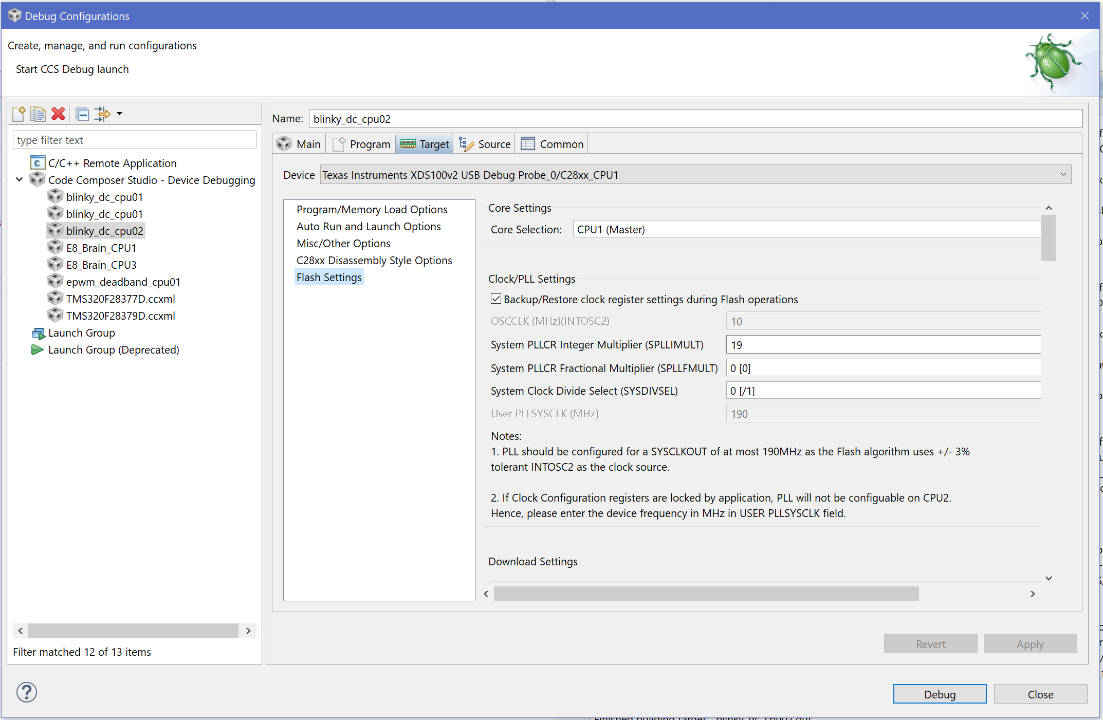

So here is a contradiction (at least for me it is). This debug configuration for the dual core blinky application for "core selection" field shows that the load should be placed into CPU1. But in fact it loads into CPU2. So what is this setting actually doing? Its obvious to me that it is not doing the obvious.
David,
Sorry to know that you are facing multiple issue on this. This started as code not loading on CPU2 but look like you are facing some basic issue with compile/linking itself. Linker cmd file is very unique to each project. Sample linker cmd file provided with example code may not work for every project and user need to update it as per their project requirement. You can find more detail on linker cmd file here.
The core selection in flash plug-in is done by tool itself based on which core you select. You don't have to change that. Also CPU1/CPU2 pre-defined in CCS properties is only for code compilation because there some resources on this device which are only accessible by CPU1 and not CPU2 but that should not prevent you from loading the code on CPU2. In the snapshot above, you have imported same project multiple time. You may want to clean that.

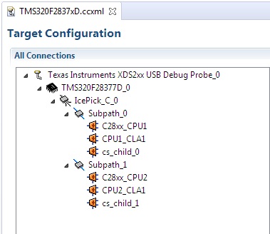

It's a little difficult to see what is happening just based on the text you provided. So, can you run a few more tests for me?
1. Find the ccxml you are using and double click to open the Target Configuration view, and then go to the "Advanced" tab. I want to make sure you have the "C28xx_CPU1" core in your configuration. This is the string that the code is trying to match when looking for CPU1.
It should look something like this:
2. Right click on that ccxml and select "Launch Selected Configuration".
- After that, connect to both CPU1 and CPU2.
- When connected, go to 'Tools -> On-Chip Flash'. This should open the flash settings for your C28 cores.
- make sure CPU1 is selected, find the Erase button in the On-Chip Flash and click on it. See if this works.
- select CPU2, find the Erase button in the On-Chip Flash and click on it. See if this works.
Please let me know the test results for this.
