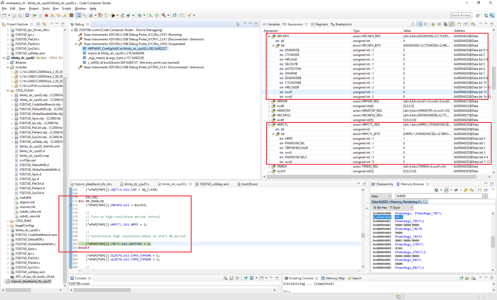

I am trying to run the example <C2000WAREINSTALLDIR>\device_support\f2837xd\examples\cpu1\hrpwm_deadband_sfo_v8 in CPU2. I am running GPIO initialization required for ePWM and allocating the ePWMs required to CPU2 in CPU1 as below
EALLOW;
CpuSysRegs.PCLKCR0.bit.TBCLKSYNC = 0;
CpuSysRegs.PCLKCR2.bit.EPWM1 = 0;
CpuSysRegs.PCLKCR2.bit.EPWM2 = 0;
/* Assign used PWM modules to CPU2 */
DevCfgRegs.CPUSEL0.bit.EPWM1 = 1;
DevCfgRegs.CPUSEL0.bit.EPWM2 = 1;
EDIS;
InitEPwm1Gpio();
InitEPwm2Gpio();
Then I perform the rest of ePWM1 and ePWM2 configuration, setting up of ISR and modification of HR period, phase inside ISR in CPU2 after enabling the clock as below
EALLOW;
CpuSysRegs.PCLKCR2.bit.EPWM1 = 1;
CpuSysRegs.PCLKCR2.bit.EPWM2 = 1;
EDIS;
// Init HRPWM1/HRPWM2
HRPWM1_Config(360);
HRPWM2_Config(360);
EALLOW;
CpuSysRegs.PCLKCR0.bit.TBCLKSYNC = 1; // Resync PWM timebase clock
(*ePWM[PWM1]).GLDCTL2.bit.OSHTLD = 1; // This should also write to
// GLDCTL2 of PWM2
EDIS;
// Configure ePWM1 to generate interrupts on period match
(*ePWM[PWM1]).ETSEL.bit.INTSEL = 1; // Interrupt on counter zero match
(*ePWM[PWM1]).ETSEL.bit.INTEN = 1; // Enable peripheral interrupt
(*ePWM[PWM1]).ETPS.bit.INTPRD = 1; // Generate interrupt on every event
PieCtrlRegs.PIEIER3.bit.INTx1 = 1; // Enable ePWM1 interrupt in PIE
IER |= 0x0004; // Enable core INT #3
EINT;

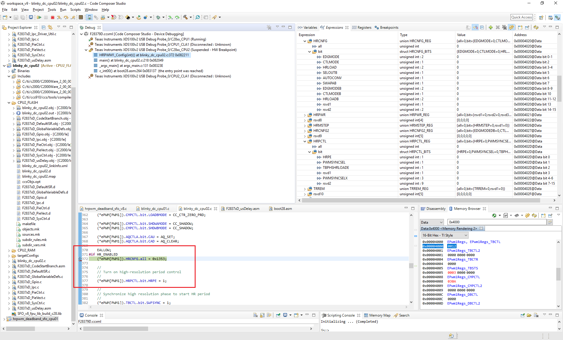

But when I check all the registers of ePWM1 and ePWM2 I see the values are set correctly except for HRCNFG register. I am not sure why this is happening. This issue is not present in CPU1 as I am able to run the example code properly in CPU1. And this issue affects only HRCNFG register and does not impact any other register settings.
I have attached screenshots from CCS with break point set to the particular instruction which will update HRCNFG register value for ePWM1, after executing the instruction by stepping over the code I still cannot observe the value in debug window but if I step through the next instruction which will set HRPE value in HRPCTL register it is updated properly.
I have also ensured that the ePWM1 and ePWM2 are allocated properly to CPU2 and clock is enabled for both ePWM1 and ePWM2.
I have also attached the source code which I have used for both CPU1 and CPU2.

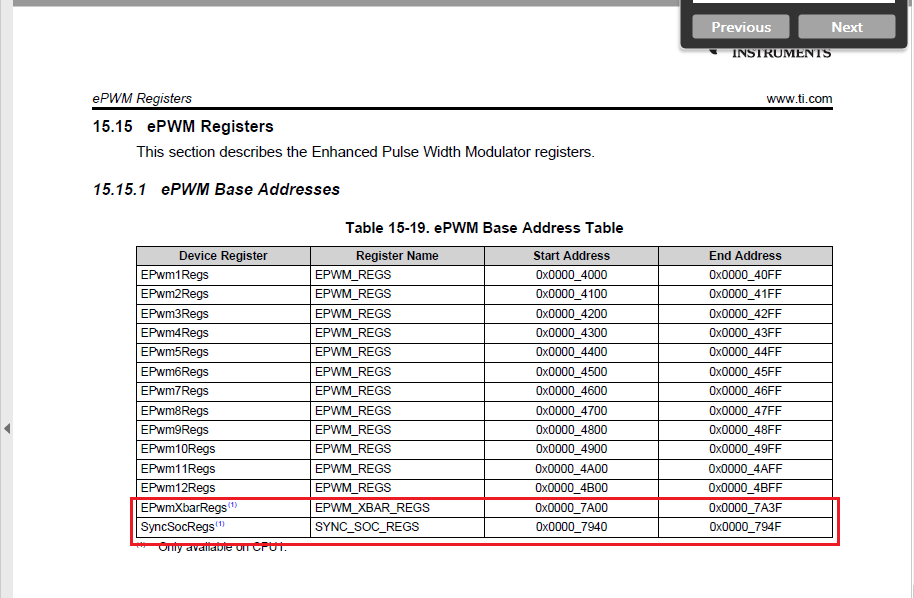

Hi Nima,
Two questions
1) Can you point me to the doc which says SFO is available only in CPU1? Does this mean we cannot consider MEP_ScaleFactor in any calculations for HRPWM in CPU2 or its just the SFO() function call will not work and this has to be done in CPU1?
2) Also HRCNFG register is just not only about SFO right? for HRCNFG = 0x1353 we will have following values
EDGEMODE = 3
CTLMODE=0
HRLOAD = 2
SELOUTB = 0
AUTOCONV = 1 (which will enable SFO)
SWAPB = 0
EDGEMODEB = 3
CTLMODEB = 0
HRLOADB = 1
which will have impact on how the HRPWM waveform needs to respond right? But these values are not being set. In TRM only SyncSocRegs and EPwmXbarRegs are indicated to be available in CPU1. So then how to proceed with HRPWM configuration for this?
Aditya
In this device, the HR configuration part of the ePWM modules only exists on ePWM1. Also SFO only runs on CPU1. Therefore ePWM1 must be allocated to CPU1 and SFO must run on CPU1.

I am assuming this statement "In this device, the HR configuration part of the ePWM modules only exists on ePWM1." means that HRCNFG for ePWM works only for CPU1 and does not work on CPU2 for all ePWMs. Please correct me if I am wrong.
Is this true for all multicore devices like F28388D for instance?
Can you update the TRM for the devices with this additional information. I do not see this in our current version of TRM.
Aditya
For F28388D device, eventhough CPU and EWPM1 still do the calibration for HRPWM, each EPWM module clocks the own HRPWM, and use the same copy of HRMSTEP calculated by the SFO. This allows HRPWM to function correctly with CPU2.
