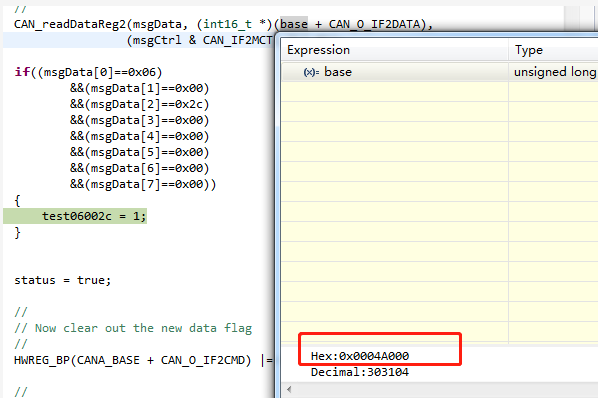

CAN-A (CAN_OUT) and CAN-B (CAN_IN) share one interruption function in boot-loader. It needs CAN-A and CAN-B during firmware upgrade.
The data in CAN-A buffer is not same with the data sending out. The error data in buffer is 06 00 2C.
Check other registers are correct, except it read CAN-B register when get base address.

Actual data:
The reading base address is CANB's.

    If yes you are configuring the ISR to get interrupt on CAN B in DCDC_CANMBOXS_Init(). That is something i can't see in the code shared. I thing you are configuring CAN B as receive that is why you are seeing the base address in Read Message.

    It can jump into interruption 0. My question is why it can't jump into interruption 1 when it has configured CAN-A and CAN-B interruption. Thanks.

    Regarding interrupts, each CAN instance (ex: CANA or CANB) has its own set of interrupt lines 0 and 1. CANA can be setup to use its own line0 interrupt and CANB can be setup to use its own line0 interrupt. These interrupt lines won't be shared. Not sure why you are using line1 for CANB.
    Now if you're trying to trigger an interrupt based on CAN status or CAN error, then only interrupt line 0 can be used.
