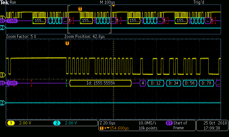

I ran can_ex3_external_transmit on my test board and I see the data coming out of CANA_TX pin. Code also works correctly, meaning CAN-A & CAN-B were able to talk to each other. The only change I had to make was to the device .h file, to change the CAN pins. In my board, CAN pin assignments are as follows:
CANTXA |
GPIO4 |
CANRXA |
GPIO5 |
CANTXB |
GPIO16 |
CANRXB |
GPIO17 |
For some reason, I was unable to capture the traffic on the bus analyzer. I will debug it tomorrow. Scope capture below:

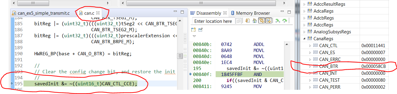

It appears there is a small error in the CANBTR value. Can you please try the procedure below and let me know if it helps?
The driverlib generates a value of 000058CB for the CANBTR register. Could you please change this to 00007FC7 and let me know if you are able to see the traffic in CAN bus analyzer. Note that CANBTR register is a protected register and you cannot change the value whenever you like.
Load the code and set a BP at line 195 of can.c file in the project directory. When code hits this line, CANBTR == 000058CB. Now, manually change the register value to 00007FC7. Resume code execution and see if bus traffic is received externally.
Daniel,
To clarify, the issue is that a bit-time of 16 does not yield a bit rate of 50 kbps (it yields 52.08 kbps). You could use a BT of 20 or 25, which yield 50 kbps. All you need to do is to change the BT parameter in the function to 20 or 25.
CAN_setBitRate(CANA_BASE, DEVICE_SYSCLK_FREQ, 500000, 25);
The value I used in the previous post (7FC7) corresponds to BT =25. There is no need to set a BP and manually tweak the CANBTR register value. You could simply change the BT value in the function call above and recompile the project and it should work. I just tested it and it worked.
