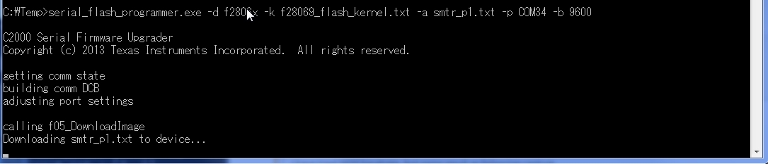

I have developed custom ACI motor driver with F28069.
I'm in trouble with serial flash downloader.
please take look at following capture of serial flash procedure
As you may see, download was not proceeded, just hold in this point, over 10 minutes, so I stopped.
Would you please let me know what is wrong with my trial ?
Hae Ryong
    It may be due to using such a high baudrate. The device on a power on reset will be running at 10MHz, so baudrate of 115200 may be too high.
    Please try using 9600. And also search the E2E forum first if you have related questions.

  • Hi sal,
    Thanks for your response.
    I have tried 9600 and 38400 baudrate, but same result as following capture.
    What else I have to look into ?

  • Hi sal,
    I could successfully flash download with newly built serial_flash_programmer with 19200 baudrate.
    There maybe something wrong with my serial_flash_programmer tool.
    Thanks for your kind support.
    Hae Ryong
