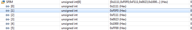

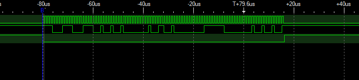

I am doing a McBSP channel B as slave and trying to read the data sent by master. This is the master data
uint16 TG0_TX_DATA[8] = {0xF0F0, 0xF111, 0x0023, 0x1000, 0xFF00, 0x1111}
And this is what I am receiving, sometimes jumbling here and there.
First of all is it advisable to do more than 32 bits on one stretch using McBSP? Is it doable ? What can I do to read it correctly?
McBSP is bit confusing, any help would be appreciated. I have attached my configuration of McBSP channel, and the master SPI signal. Can you let me know why I get jumbled?

    Yes, the McBSP can handle larger than 32 bit data at a time. The an important thing to note is that the McBSP aslo requires a toggle on the FSX pin between each 32bit word.
    Please go through the table "Bit Values Required to Configure the McBSP as an SPI Slave" verify that you are setting up these bits correctly. I have seen where if just one bit is off, the McBSP can operate in undefined ways even when appearing to work some of the time.
    Link to the TRM: http://www.ti.com/lit/spruhm8
    Please meticulously check your configuration.
