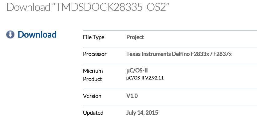

This is the project of uCOSII downloaded from Micrium

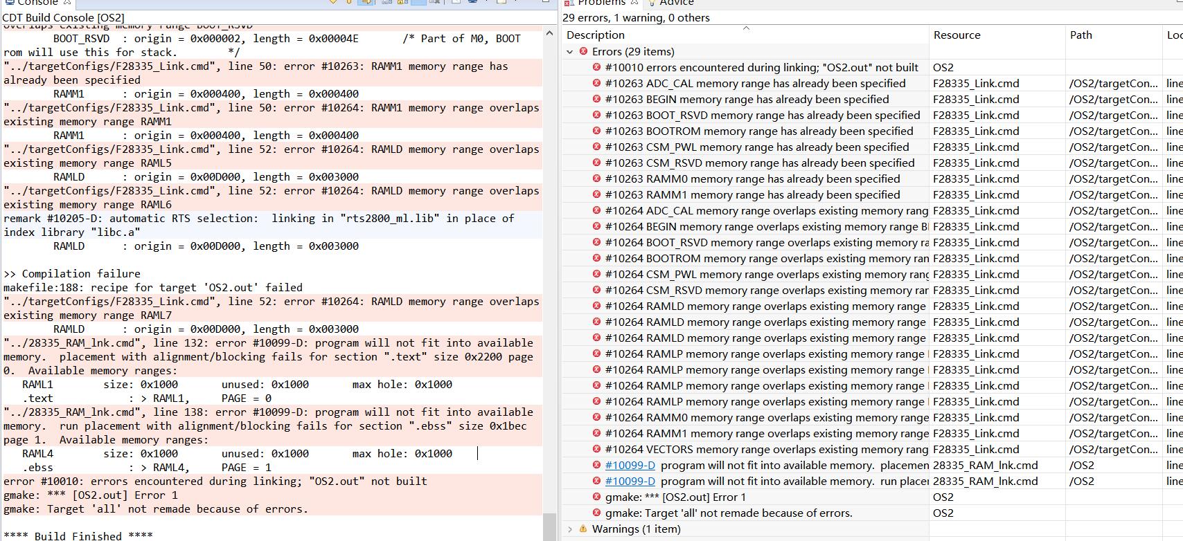

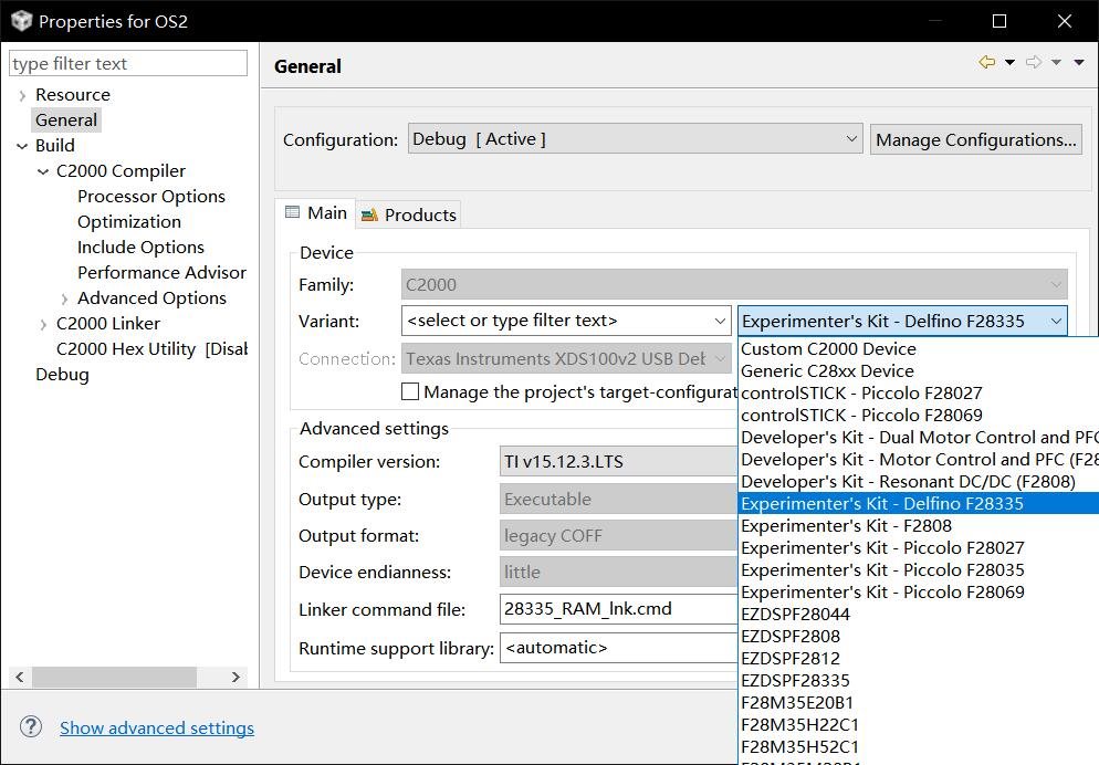

There is no error in using experimenter's kit - delfino f28335 compilation, but the following error occurred in the TMS320F28335 compilation.
I want to know the difference of Experimenter's Kit - Delfino F28335 and TMS320F28335.

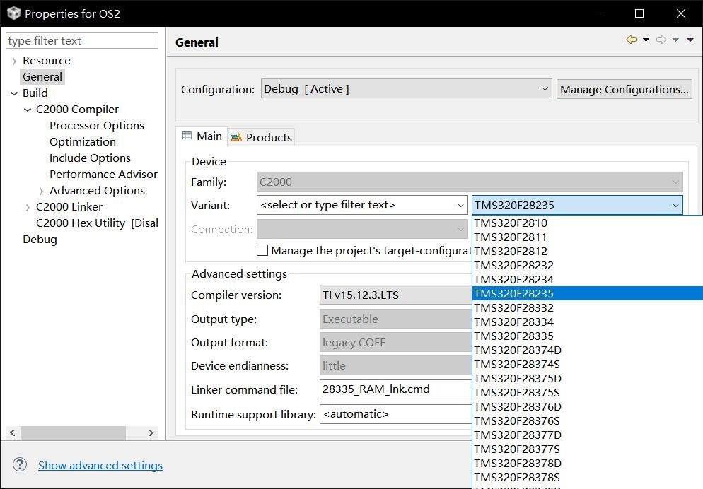

    When you import a project, it would bring in its linker command file.
    My suspicion is that in the TMS320F28335 target configuration the project is now trying to pull in a new linker command file which it expects that you will need based on what "Variant" you've selected.  When compiling/linking, the project would now see two linker command files - resulting in the conflicts you are seeing.
    For the TMS320F28335 target configuration within the Project Properties, what happens if you choose to not pull in a .cmd file in the 'Linker Commend File' dropdown?
