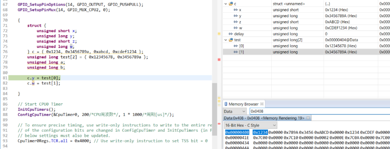

Our customer wants to know how to prevent 16 bit padding in the code as shown below.
    struct {
        unsigned short x;
        unsigned long y;
        unsigned short z;
        unsigned long w;
    } c = { 0x1234, 0x3456789a, 0xabcd, 0xcdef1234 };

    I believe the reason is you have a short variable followed by a long variable. A long variable should be always aligned by 2 bytes. That is, the start address needs to even (not odd) That is the reason you see 16 bit padding in between the short and long variables.
    Could you rearrange the struct as shown below?
    struct {
    short x;
    short z;
    long y;
    long w;
    This makes sure that x and z occupies the first 2 bytes nad the next available address is aligned by 2 bytes

    Since a long variable is of size 2 bytes, I assume the compiler auto-aligns the variable to get an even address. I am not sure if there is a way to have long variable with unaligned address.

  • Unfortunately, the C2000 compiler has no method for packing the members of a structure.
