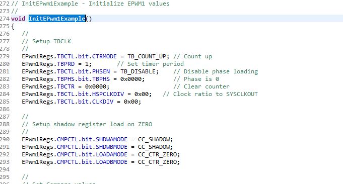

I am using EPWM up counting example, I have changed clock division settings and counting only 1 pulse (EPwm1Regs.TBPRD = 1).

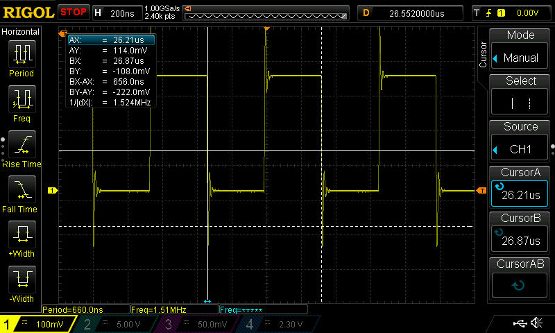

In Epwm ISR, I am toggling GPIO25 to verify frequency on the oscilloscope. I am not seeing frequency close to 200 Mhz. I am seeing frequency as 1 MHz.
 My changed code:

// epwm1_isr - EPWM1 ISR to update compare values
__interrupt void epwm1_isr(void)
    GpioDataRegs.GPATOGGLE.bit.GPIO25 = 1;

// InitEPwm1Example - Initialize EPWM1 values
void InitEPwm1Example()
   // Setup TBCLK
   EPwm1Regs.TBCTL.bit.CTRMODE = TB_COUNT_UP; // Count up
   EPwm1Regs.TBPRD = 1;       // Set timer period
   EPwm1Regs.TBCTL.bit.PHSEN = TB_DISABLE;    // Disable phase loading
   EPwm1Regs.TBPHS.bit.TBPHS = 0x0000;        // Phase is 0
   EPwm1Regs.TBCTR = 0x0000;                  // Clear counter
   EPwm1Regs.TBCTL.bit.HSPCLKDIV = 0x00;   // Clock ratio to SYSCLKOUT
   EPwm1Regs.TBCTL.bit.CLKDIV = 0x00;

Clock settings I changed and code changes highlighted in the following images>
Above image is oscilloscope print connected on GPIO25 pin.
Let me know if my understanding and configurations are wrong.
Is this the maximum frequency we can obtain with this EPWM up counting?

  • Hi, PWM output frequency is not same as the Interrupt frequency.
    You can not possibly set the period to 1 as the interrupts will be generated at very high rate that CPU will not be able to address those interrupts.
    What you are observing is the artifact of the same cause. Also, PWM should not be switched at 200MHz - maximum operating frequency of PWM clock is 100MHz. GPIO's will not be able to switch at such high frequency either - so limit the frequency of output toggle to 25MHz max.
    Start with a lower frequency and vary/increase in steps to understand the module behavior.
  • Hi Subrahmanya,
    I have already reduced clock div to divide by 1 which means epwm clock is also ticking with 200mhz right?
    if i change prescale value to divide by 200, I should get 1mhz as a epwm frequency. In that case my GPIO should tick after every 1us. Let me know if my assumptions are wrong. Can GPIO toggle at this rate?
    Akshay
    Please refer to device data sheet and TRM.
    "The Type 4 ePWM clocking varies from previous ePWM types . Prior to the Type 4 ePWM,
    the time-base submodule was clocked directly by the system clock ( SYSCLKOUT ) . On this
    version of the ePWM , there is a divider ( EPWMCLKDIV ) of the system clock which defaults
    to EPWMCLK = SYSCLKOUT/2"
    As mentioned earlier, this module is designed to operate at a maximum of 100MHz.
    Regarding how to get a desired frequency PWM Output refer to
    "15.4.3 Calculating PWM Period and Frequency" of the technical reference manual
    www.ti.com/.../spruhm8
  • maximum frequency I could test was 50 mhz.
    where I kept Clk divs divide by and TBPRD =0.
    AQCTLA was toggle on zero.
    I am excited to know how to reach 100 mhz.
    Can you help me with the code
    Akshay
    100MHz max is for the EPWM clock frequency.
    Refer to Table 5-12. Internal Clock Frequencies in the device data sheet www.ti.com/.../tms320f28377s.pdf
    This is not applicable for the Output switching frequency of the PWM output.
    As I mentioned earlier, it should be limited to 25MHz - due to IO toggle frequency limits.
    What exactly is your application? It's unusual to use EPWM with a TBPRD of Zero value.
