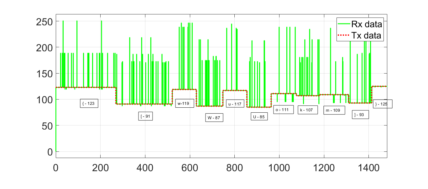

Only certain characters echoback (w,W,u,U,o,k,m,[,],{,}). This is done using Simulink and as well as in terminal available in code composer (CCSv6).
When I transmit any other characters apart from this it does not echo back correctly. Furthermore, after two characters other than the list it stops echoing.

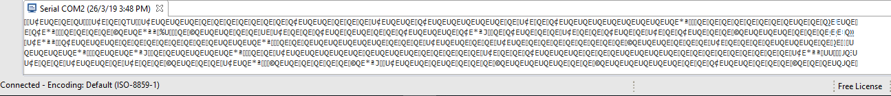

When I transmit the values 3,4,255,0 continuously in main(), I receive garbage values as shown in terminal and Simulink view.
Terminal view
Simulink view

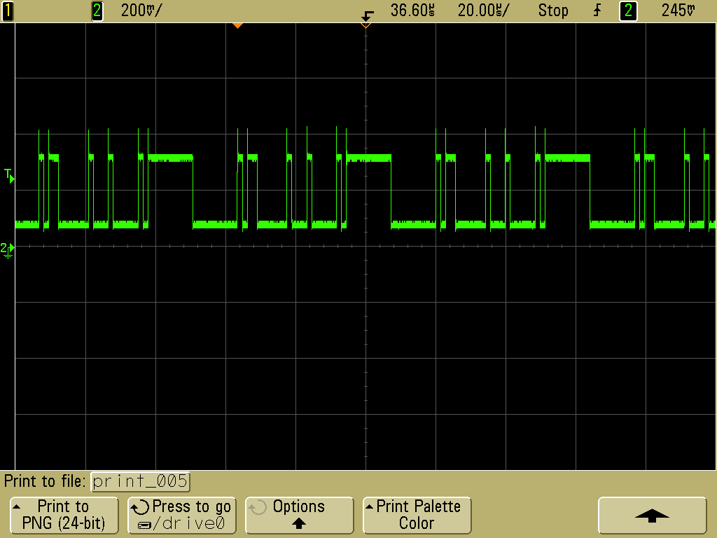

To check whether I receive data correctly at SCIA terminal of the TAPAS board from the MCU, I used an oscilloscope to view at GPIO 29 directly. This result is given below and it seemed alright.

I tried sending the values 3,4,255,0 at 1 Hz in mainISR(). This resulted in garbage values as well but different from the above.
Terminal view
Simulink view

These are the values during constant transmission of values 3,4,255 in ISR at 1 Hz.
I also tried the same code with LAUNCHXL-F28069M development kit and received the same output.
Furthermore, I tested SIEMENS TAPAS converter board with controlsuite echo back example and it worked fine.
But, I could not figure out why SCI doesn't work properly with motorware code.
