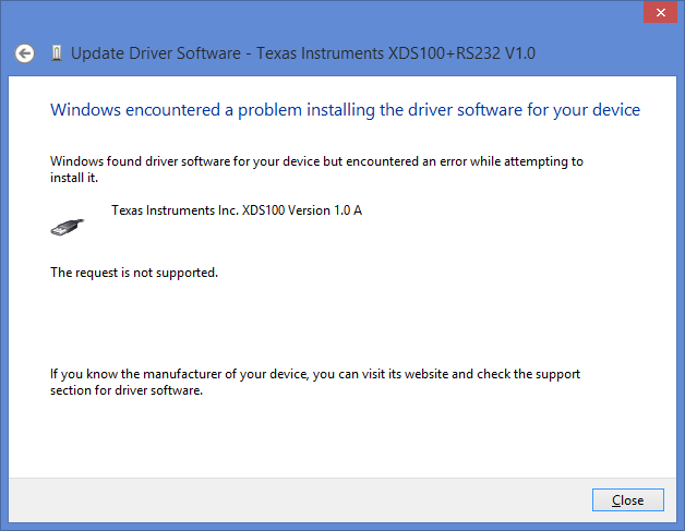

    Thank you for the rely. I followed the steps. "Load VCP" was already checked even before. At the end I I was not able to get COM ports to appear. After some more playing around and trying different stuff, now I cannot see TI XDS100 Channel A or B under Universal Serial controllers menu. I can see Texas Instruments XDS100+RS232 v1.0.
    There are several topics already with this issue on the forum (e.g. 1 and 2), but they do not provide solutions. I even came across some suggestions to delete usb.inf and drivers... did that help... Last option is to reinstall Windows.
    If I try to manually update the drivers and point to C:\ti\controlSUITE\development_kits\~Utilities\XDS100 Drivers v1.0, the process is unsuccessful and I get the following message:

    I have the setup as you - F28335 with docking station, connected to the USB XDS100v1. I reprogrammed the EEPROM as you did following the same instructions - it worked as expected. I'm not sure what the issue is on your end, likely something with your PC environment. Can you get everything recognized on another PC? Also, what is the host OS? Looks like Windows 10. What build?

    yes, it seems there was a problem with my local machine and USB drivers. I did a fresh install and now everything works okay. Prior to that I was trying to enable CAN communication and probably something went wrong.
    thanks for the help and advices.
