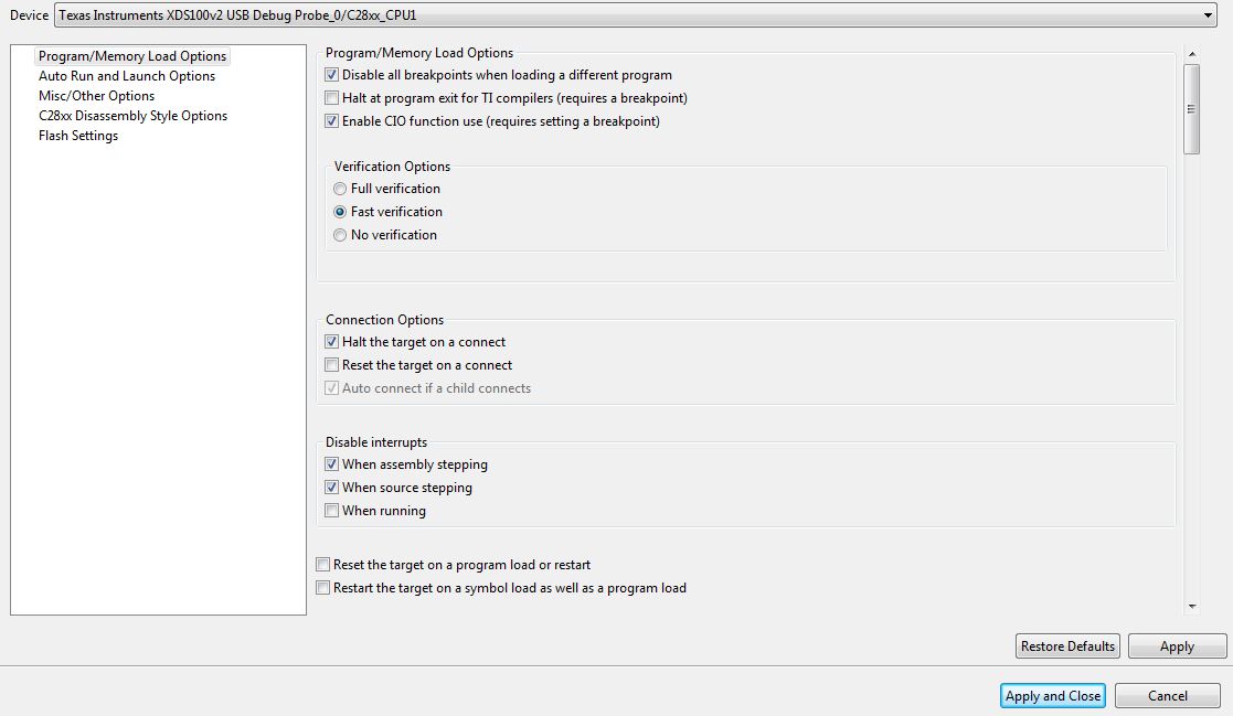

I am using LAUNCHXL-F28379D for my application. When I use the debug mode on CCS, code is uploading to the micro controller but when I try to run the program in debug window program is halt with dummy values on the watch window. Please help me to resolve this issue. I would like to know which parameters should be modified in the JTAG/Debugger settings in order to run my code in debug mode properly.

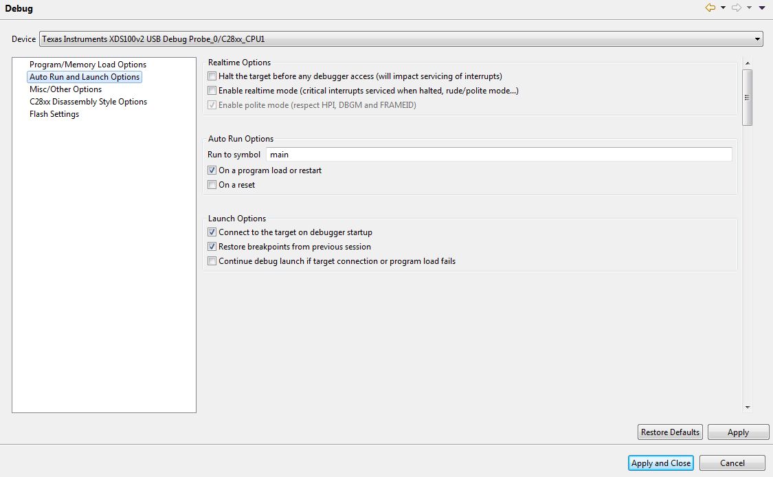

  • HI Matthew,
    Other code are working fine. The code i'm specifying is not give any compilation errors and load to the micro controller properly. When I try to run the code from the debug window it is not working in the intended manner. My settings for the debugger as follows. Please let me know if I require any modifications to the following settings.

  • Lahiru,
    I should have been more specific; there are no settings for the emulator/emulator actions that would effect the connection to the device in the manner you have described.
    My thought is that something in your code, when executed, is terminating the connection or resetting the device. For instance, all of our devices have a watchdog module to prevent run away code in the final application. However, during debug(and our examples) we typically disable this so that the user doesn't have to comprehend writing to it to prevent it from triggering(which is a reset action).
    That is just one example, there are other possibilities like over clocking the device with too high a PLL setting, or not initializing the ECC, etc. Most of these are taken care of/given an example of in our C2000Ware examples, which is why I suggested looking there.
    If you have based your code on these examples, for instance taking the setup portion of the examples(clock, device config, etc) then we can rule some things out. If not, we need to see if there are initializations that are not the same between your code and our examples and start there.
