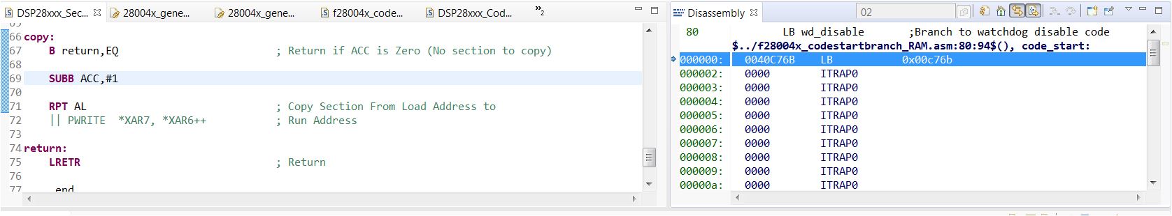

I have been running my code from flash and am looking to speed up the execution time by running it out of RAM. I read through and followed the instructions mentioned in this app note: http://www.ti.com/lit/an/spraau8a/spraau8a.pdf
I modified my linker command file and the codestartbranch.asm files and modified and used the DSP28xxx_SectionCopy_nonBIOS.asm file from the app note for copying the compiler sections from Flash to RAM at startup. The code compiles and am able to flash but after flashing it the code gets stuck at address 0x3fbd92 with the following message:
Break at address "0x3fbd92" with no debug information available, or outside of program code.
Below is a screenshot of the debug window. I am not sure what or where the issue might be.
Also I have attached the linker command file, the modified codestartbranch.asm and DSP28xxx_SectionCopy_nonBIOS.asm files.
7585.Files.zip

    Here are some debug tips that can help:
    1) In your latest snap, control is at code_start.  You may have disabled "run to symbol main" on "a program load or restart" in the debugger settings (Check CCS Debug view -> Tools -> Debugger options -> AutoRun and Launch options").
    If you step from the code_start, what does it do?  Ideally, if you map things correctly, control should go to watch disable code from here before it starts copying sections to RAM.
    2) At code_start, there is a long branch to 0xC76B.  Did you check what is loaded at that address?  In your linker cmd file, that address is in PAGE 1.  Is it intentional?  I am not sure what you mapped there.  Please check.
    3) In your codestartbranch asm file, you coded ".text wd_disable".  Do you mean to code ".sect "wddisable""?  I see you mapped wddisable to Flash in your linker cmd and hence asking.
    4) There is 256KB of Flash and 100KB of RAM on this device.  Hence, if you want to map all the sections to RAM, you need to make sure your application won't exceed 100KB - Did you already analyze this?
    5) Make sure to remove memcpy(&RamfuncsRunStart, &RamfuncsLoadStart, (size_t)&RamfuncsLoadSize) since the code gets copied by "DSP28xxx_SectionCopy_nonBIOS.asm" even before reaching _c_int00.
    6) Did you replace any .sect “ramfuncs” (or .sect ".TI.ramfunc") in any of the asm files to .sect “text” so that "DSP28xxx_SectionCopy_nonBIOS.asm" can copy those sections as part of .text section?  I see that sectioncopy asm does not copy ramfuncs and hence asking.
    7) Also in your application, please remove any #pragma CODE_SECTION(xx, “ramfuncs”) (or #pragma CODE_SECTION(xx, “.TI.ramfunc”)) so that they get mapped to .text section.
    8) Looks like you started the thread showing an ITRAP error.  Are you able to get rid of the ITRAP now?
    Hope this helps.

  • Hi Vamsi,
    Thanks for looking into the issue. I apologize for the late reply!! I had some other tasks to attend to.
    I did manage to check the Flash settings. The wait state is set to 4 and Flash prefetch and data cache are Enabled.
    As for other suggestions you had below are my comments:
    I checked the debugger options and "run to symbol main" on "a program load or restart"  is checked/Enabled.
    When I pause the execution for single step looks like it is stuck at "00c5ea" which seems to be part of RAMGS0 and I do not have any instructions to copy any sections into this portion of the RAM in my linker file. So I am not sure how the program gets to this address.
    This is not intentional. This seems to be a part of RAMGS0 and I do not have any sections assigned to this portion of RAM. So I am not sure why the branch instruction to this address is there.
    I had already modified the files that I attached at the beginning before my last post to change .text to .sect, but forgot to attach the files in my last post. Please check the attachment below for the updated files.
    - The application does not exceed the RAM limit. Before I started making changes to copy the code from Flash to RAM, I changed my Active Build Configuration to CPU1_RAM and was able to run the application from RAM with the debugger connected. I did not have any issues when I did this and noticed the faster execution time.
    - I commented out this memcpy section inside the InitSysCtrl() funtion as per your suggestion, but this did not change the outcome.
     The asm files did not have any .sect “ramfuncs” (or .sect ".TI.ramfunc"). I added instruction to the "DSP28xxx_SectionCopy_nonBIOS.asm" to copy the ramfuncs sections after my last post. Please check the attached files below to review the instructions used for copying this section.I do not know if this is required or not. This however did not make any difference.
    - I do not have these instructions in my code.
    - After the changes I made to the .asm and the liker command file before my last post I do not get the ITRAP error now.
    Please let me know if you need any more info!!

    You will not get a compilation error. The command won't split the sections as it does in other cases. This is a different case where the sections are copied run time. This query can be separately discussed in compiler forum.
    To observe if the copy happened as expected from FLASH to RAM. You can step in to the code post to the location where the copy occurred. Watch the
    XXXX_loadend, XXXX_loadsize, XXXX_loadstart values. where XXXX is cinit, text, econst etc.

  • Hi Katta,
    I tried out your suggestion of combining the RAM into a single block. I still have the same issue as before.
    I also stepped to the RAM addresses to check if the code was copied but it looks like it was not. What could be the reason for this?
