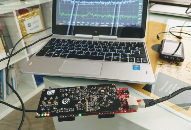

  • The Ethernet port.
    We come from the ARM M4 Tiva family, and in our radar design, the Ethernet comm port is used as a high speed FFT debugging and logging port, besides from a remote connection controller. Both an external app and control center communicate wih the chip.
    After that we developed a more complex solution, where a C2000 F29379D chip was used, and on the same board we mounted another Tiva device for the same purpose. We communicated those chips via SPI, but you need to mount two chips, a  growing BOM and double software.
    We would benefit highly in our developed prototypes from this chip.
