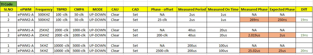

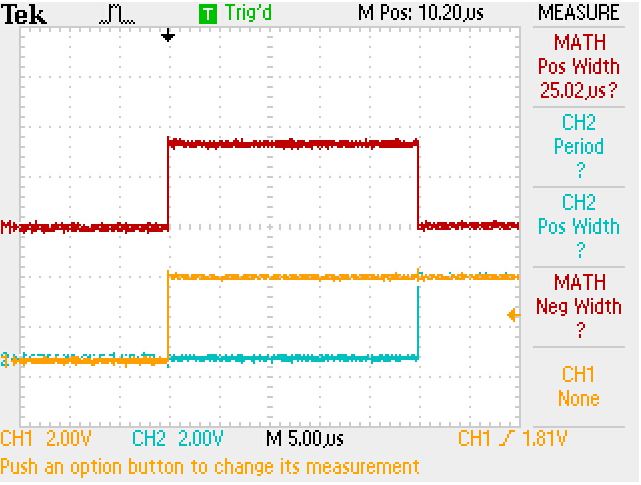

The figure is for the last case from the table.
Please let me know if I am missing anything here.
    The EPWM clock freq is 100MHZ.

    Ok, I agree. But, since the delay is from Master to Slave, the master TBCTR would have incremented by 2 by the time Slave count begins. That way, we should see a difference of 20ns less between Master and Slave. But with TI code, I see the difference is more by 20ns at EPWMCLK of 100 MHZ and condition being - if ( TBCLK = EPWMCLK): 2 x EPWMCLK.
    I also have this captured in my table and waveform.
