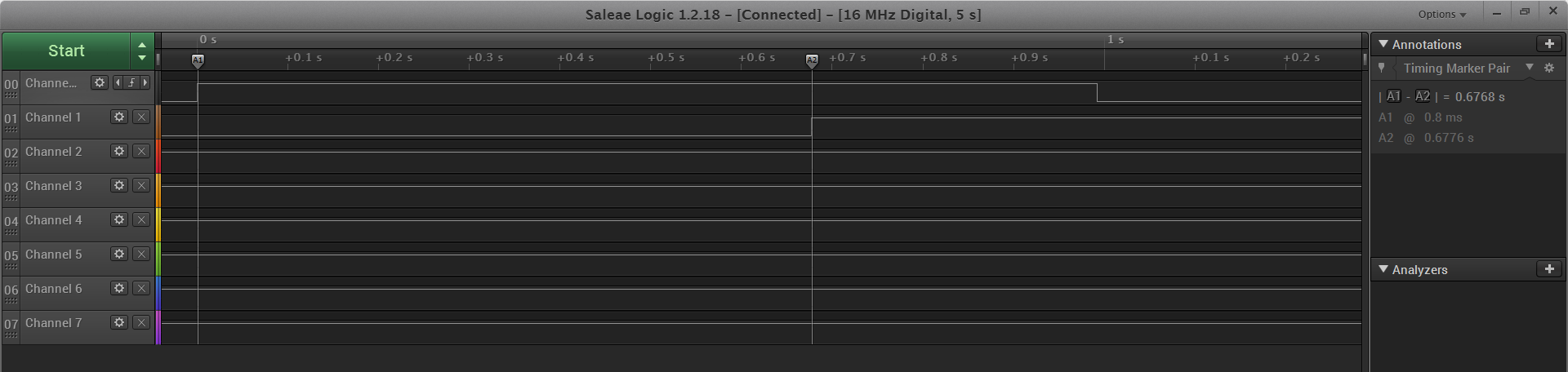

Hello all!
I am trying to implement the following very basic function:
I would like to run two interrupts, one of which runs at 10kHz, whilst the other one runs at 0.1ms. The two interrupts basically do the same thing: they switch on  the onboard led for one second than they switch it off for an other 1 second. So what I would like to test, is the nested interrupt capabilities of the C2000 MCU, focusing on the interrupts occurs at the same time, coming from the same group.
My problem, that the nested interrupt configuration seems to be not working, because there is way to much time between the switch on of  the LEDs.
As you can see on the first figure, this time delay between the switchings is about 2.67ms after powering the board. On the top of that, this time is increasing during the run.
This is my code for the EPWM setup:
