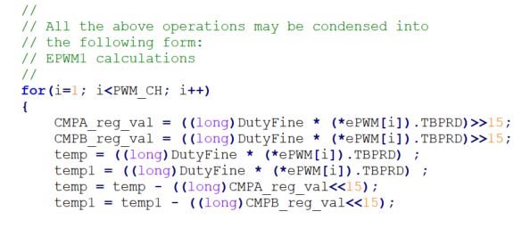

I am promoting F280049 for a customer demanding high frequency DC/DC solution (over 200k). In order to present the HRPWM performance of F280049, I am trying to perform some tests on F280049 launchpad based on the example code:hrpwm_ex1_duty_sfo_v8. And here is some strange findings.
The original code was a duty cycle sweeping demo. In order to show the duty cycle accuracy enabled HRPWM under high frequency, I changed it into a fixed frequency version. By changing the Line 201 into:
for(DutyFine = 0x2000 ; DutyFine < 0x2001; DutyFine++)
First group test is under 10Mhz and here is the result:
Q15 Number Duty cycle Result
0x4000 50% 45.31%
0X4cc1 60% 54.36%
0x2666 30% Fault
0x2000 20% 19.80%
Question:
1. As shown in the result, I believe, the duty cycle accuracy did not meet the expectations. Since we support 150ps resolution, we should not have ~5% error under 10Mhz PWM. Could you help to explain if there is any misunderstanding?
2. As you can see, when I changed the dutyFine value into 0x2666 to achieve 30% duty cycle. I got a scope as below. Seems the PWM got high twice in a switching period. And this can be observed in the original example code where dutyFine = 0x3000.

    Can you please tell me which C2000Ware version you are using to do this evaluation. Because the default example had couple of bugs which are resolved in the latest C2000Ware release. I believe that you are getting huge error in duty due to this bug only :
    In the above configuration, '1' is not added to the TBPRD register value for computation. Thus it should be modified as :

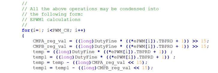

    I am using C2000Ware_1_00_06_00 and the +1 is indeed missed.
    However, after adding the +1 to the original code, I still cannot get the correct result. Still getting a 25% duty cycle PWM when dutyfine=0x2000.
    Did I misunderstood how the dutyfine should be calculated when given a duty cycle. For example, if I want to get a 20% duty cycle, how the get the correct dutyfine value?
    Brian
  • Hi Brian,
    For dutyfine = 0x2000, if you are getting 25% duty cycle then its correct right as 0x2000 represents 0.25 in Q15 format.
    For duty = 0.2, Q15 value is 0x199A, you need to use that as dutyfine.
    If my reply answers your question please click on "This resolved my issue" button located at the bottom of my post.
    Himanshu
  • Hi Himanshu,
    After adding the +1 code to original example. The program can work normally now.
    However, this bring 2 addtion questions:
    1) Why we need this +1 to the right result?
    2) I went through the detailed code to calculate the value of CMPAHR:
    CMPAHR_reg_val = ((temp*MEP_ScaleFactor)+(0x0080<<7))>>15;
    CMPAHR_reg_val = CMPAHR_reg_val << 8;
    CMPBHR_reg_val = ((temp1*MEP_ScaleFactor)+(0x0080<<7))>>15;
    CMPBHR_reg_val = CMPBHR_reg_val << 8;
      My question si why we need to add 0.5 (0x0080) to the result of CMPAHR?
    Brian
  • Hi Brian,
    1) The actual value of period is the programmed (register value + 1). This is due to the factor that the counter starts from 0 and not 1, you can find further details around this in the device datasheet.
    2) 0.5 is added to take care of truncation error as in C by default the decimals are truncated and not rounded off while assigning to a integer variable.
