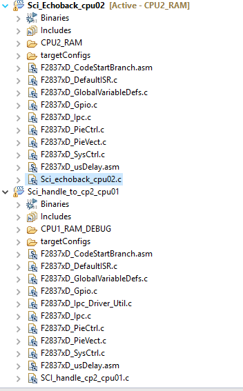

here is the snapshot of project folder and added files-
It seems like the CPU02 is not getting access to the SCI registers.
Please help.
Thanks in advance.
  • hi,
    When you say that the cpu2 not getting access to SCI registers , is the SCI peripheral enable being done on the cpu2 side ?
    Is the CPU2 running ahead of the configurations done by the cpu1?
    Could you take a look at the C2000Ware\device_support\f2837xd\examples\dual\ipc_gpio_toggle example to check if the IPC looks fine ?
    Regards.
  • Hello Meghana,
    Thank you for you answer. First of all, I modified the ipc_gpio_toggle example for this code. I intialized the pinmuxing using core1
    //part of core 1 code
    InitGpio(); // Skipped for this example
    EALLOW;
    GpioCtrlRegs.GPADIR.bit.GPIO31 = 1;
    GPIO_SetupPinMux(43, GPIO_MUX_CPU2, 0xF);
    GPIO_SetupPinOptions(43, GPIO_INPUT, GPIO_PUSHPULL);
    GPIO_SetupPinMux(42, GPIO_MUX_CPU2, 0xF);
    GPIO_SetupPinOptions(42, GPIO_OUTPUT, GPIO_ASYNC);
    for(i=0;i<8;i++)
    GPIO_SetupPinMux(i,GPIO_MUX_CPU2,0);
    GPIO_SetupPinOptions(i, GPIO_INPUT,GPIO_PULLUP);
    then I place the IPC codes from (Ipc_gpio_toggle)
    #ifdef _STANDALONE
    #ifdef _FLASH
    // Send boot command to allow the CPU2 application to begin execution
    IPCBootCPU2(C1C2_BROM_BOOTMODE_BOOT_FROM_FLASH);
    #else
    IPCBootCPU2(C1C2_BROM_BOOTMODE_BOOT_FROM_RAM);
    #endif
    #endif
    // Call Flash Initialization to setup flash waitstates
    // This function must reside in RAM
    #ifdef _FLASH
    InitFlash();
    #endif
    I also initiate the scia_init() on core 2 as well.
    Other than that I didn't understand what did you mean by saying enabling SCi by cpu2.
    Could you elaborate, please?
    Thank you.
