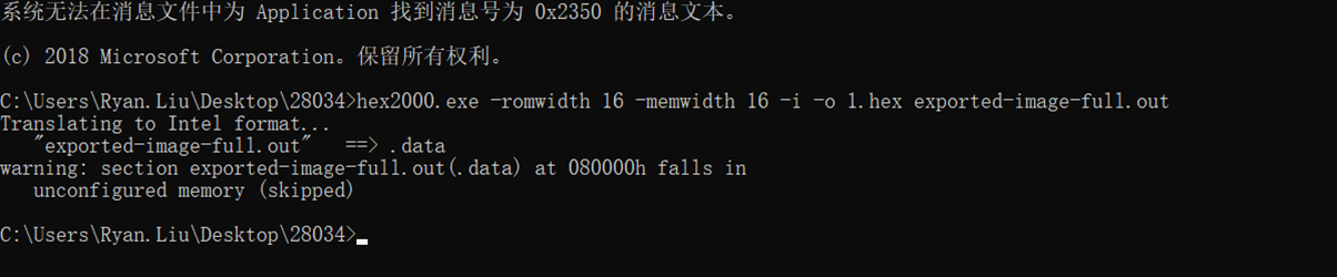

My customer created exported-image-full.out through memory exporting with an UniFlash tool on a already programmed device and converting it to .hex using below command.
hex2000.exe -romwidth 16 -memwidth 16 -i -o 1.hex exported-image-full.out
Error raised in this process:
But they can get .hex generated with no problem in CCS build process.
Why is that?

The hex utility is only tested to work with files created by the C28x compiler tools (specifically the linker), and not files created by this method ...
Sheldon He said:My customer created exported-image-full.out through memory exporting with an UniFlash tool
Please describe the overall problem the customer wants to solve. There is probably a better way to do it.

They are tring to program both flash and OTP with one single image. So, they tried to read the flash and OTP content of a already programmed device to generate a .out file, then create .hex and .bin image for programming.

Why can't they use the hex file generated by CCS when the project is compiled? Why do they need to download the image from a programmed device?
