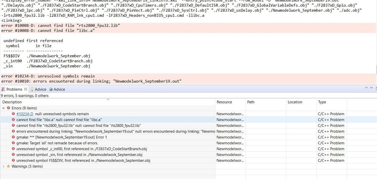

I am trying to develop a control code on launchpad TMS320F28379D. The code is working properly on a particular PC. Due to some issues, the code has to be compiled on another work station. I have linked the header files from the controlSuite in the new PC. But for the same code, I am getting a particular error. I am including the output of the console and the error description.

    Did you install CCS on new PC. rts2800_fpu32.lib, and libc.a are part of TI compiler.
    <CCS Install>./ccs/tools/compiler/ti-cgt-c2000_18.12.4.LTS/lib/rts2800_fpu32.lib
  • I have reinstalled the CCS. But the same problem persists even now. I had one more doubt- Where can I find the RAM Link file for the device?

    Did it install CCS successfully on the new PC? Please try a simple C2000ware DriverLib example on new PC just to make sure you CCS installation was good.
