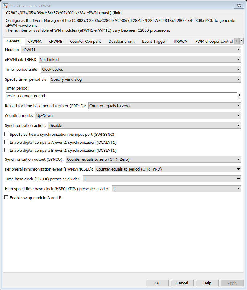

I'm having trouble producing PWM signal using Space Vector Generator DQ in Simulink.
How should i set the ePWM Module parameter so that it can produce the right signal?

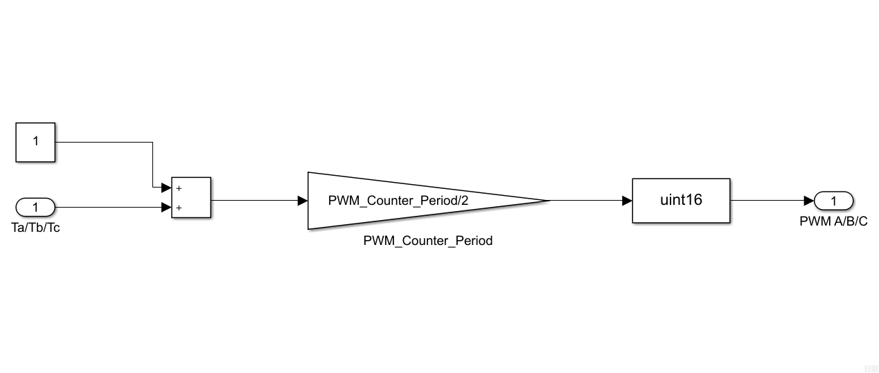

    To implement generation of correct PWM duty cycles, you’ll need to scale the 'Ta, Tb and Tc' outputs of SVGenDQ block to PWM Counter period. The ePWM block works with a timer count (e.g. For image below PWM_Counter_Period = 4 clock cycles)
    You may compute PWM_Counter_Period by using the following math:
    CPU_frequency = 200e6; %(Hz)
    PWM_frequency = 20e3; %(Hz)
    PWM_Counter_Period = CPU_frequency/PWM_frequency/2; %(PWM timer counts)
    An example is shown in the model below.
    This can also be accessed by the example model of the LaunchXL-F28379D by typing ‘c28379Dpmsmfocdual_cpu1_ert’ at your MATLAB command window. The required subsystem is present at following location in the model: ‘c28379Dpmsmfocdual_cpu1_ert/FOC Alogrithm Motor/Torque Control Algorithm/Generating Space Vectors’
    The PWM Scaling subsystem is shown below.
    Once you obtain the required PWM_Counts for generation of PWMs, you may configure the ePWM blocks to generate space vectors via multiple options, as shown below. Note that the timer period units are CPU clock cycles, which are used to obtain the required PWM time period.
    There are multiple events that can be configured to generate outputs. The image below illustrates CMPA and CMPB values (which are the PWM_Counts computed by you).
