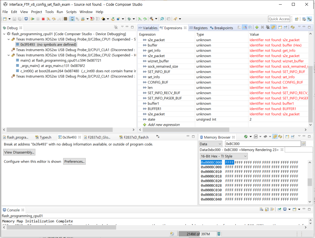

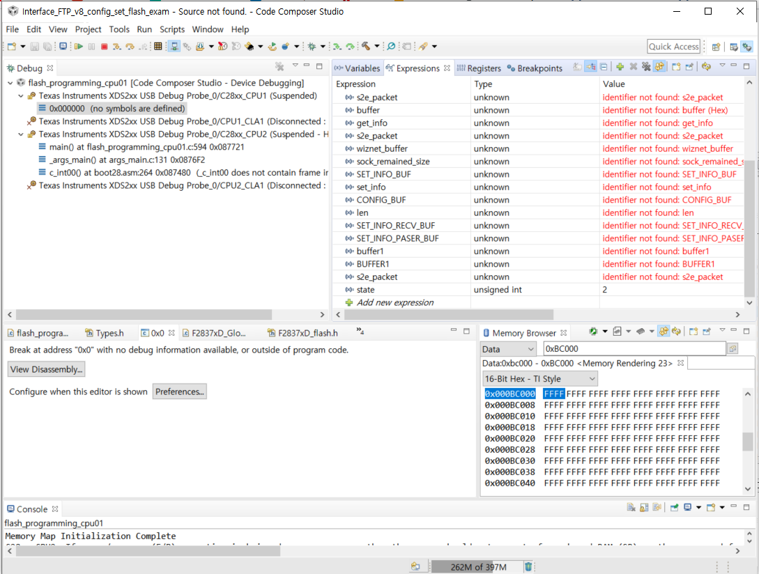

We face a strange question using F021 Flash API. The device is F28377D and Flash API of C2000Ware_2_00_00_02.
Firstly, the board HW is no problem, we can run the example code fine.
But when we add the Flash API into the SDS200i with CCS SW, we face this question.

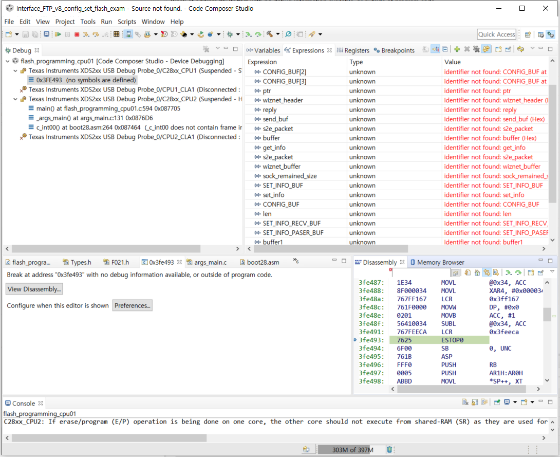

1. When calling Fapi_issueAsyncCommandWithAddress to erase Flash, oReturnCheck = Fapi_issueAsyncCommandWithAddress(Fapi_EraseSector, (uint32 *)Bzero_SectorM_start);
We program sector M first, then erase sector M using "Flash, oReturnCheck = Fapi_issueAsyncCommandWithAddress(Fapi_EraseSector, (uint32 *)Bzero_SectorM_start);", will report there is no source code error or go to illegal area like below picture.
2. Over to the next step, It will also report a similar problem like the below picture.
I refer to below another post, but I couldn't solve it
e2e.ti.com/.../552162
Please kindly help to comment and provide suggestions.
Thanks and best regards,
Edward

  • Edward,
    Looks like you are executing Flash API functions from Flash.  Correct?
    If you take a look at the linker command file used by the Flash API usage example (C2000Ware_x_xx_xx_xx\device_support\f2837xd\examples\dual\flash_programming\cpu01\flash_programming_cpu1_FLASH.cmd), you will notice that Flash API library and ramfuncs (or .TI.ramfunc) are grouped together and given a Flash load address and a RAM run address.
    Can you try this and let me know if this fixes your issue?
    Thanks and regards,
    Vamsi
  • Edward,
    As mentioned in Table 4-13. Wait Point Addresses for CPU1 of the TRM (http://www.ti.com/lit/ug/spruhm8h/spruhm8h.pdf), your application is ending up in ITRAP ISR.
    As I suggested earlier, please assign a Flash load address and RAM run address for ramfuncs and Flash API library.  And call memcpy() function before executing any of the Flash API functions or the ramfuncs code.
    Thanks and regards,
