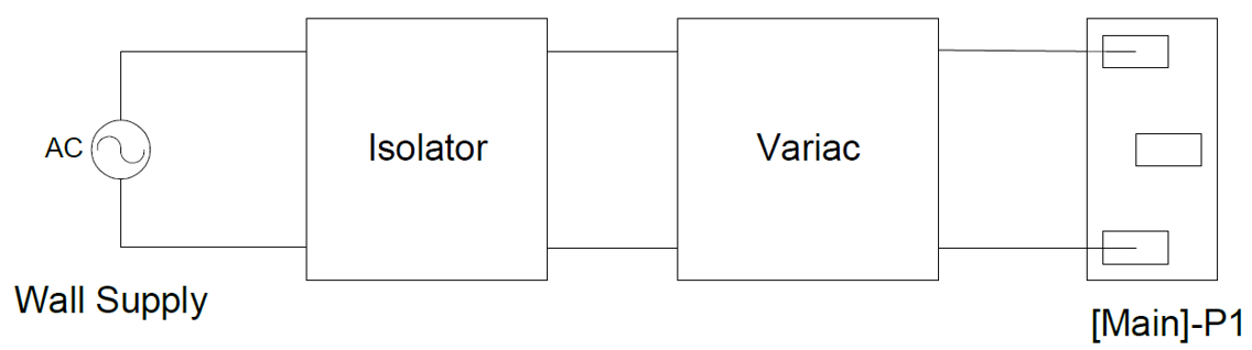

I try to drive my 3 phase PMSM using TMDSHVMTRPFCKIT with MCU f28035.
As I know, there are three ways to supply DC bus voltage for 3 phase inverter stage. (1. DC supply / 2. AC entry / 3. AC entry + PFC)
When I supply DC bus voltage directly by using DC power supply, there was no problem and PMSM was drived well.
However, when I supply DC bus voltage through AC power entry with 220 VAC wall supply, the problem happened.
I don't use PFC stage so that BS1 and BS5 were connected each other and other circuits including MCU were not powered yet.
When I turned switch of power strip on to supply 220 VAC from wall to the board, some spark and sound with a pop occurs in my board.
After this accident, I saw that AC power supply is recommended through isolator and variac as shown in the following figure, but I didn't at that time.
So, my question is
1. How can I supply DC bus voltage safely through AC power entry with AC voltage?
2. If I use isolator and variac, then can I expect to supply DC bus voltage safely?
3. What is the roles of isolator and variac?
4. Please, give me some recommendation for isolator and variac.
I will be waiting for your answer.
Thank you.
Please download and install the controlSUIE, you can find the hardware guide about this kit, please take a look at the guide that includes the detailed operation steps, please follow it to use this kit. The guide is at ti\controlSUITE\development_kits\HVMotorCtrl+PfcKit_v2.1\~Docs.
