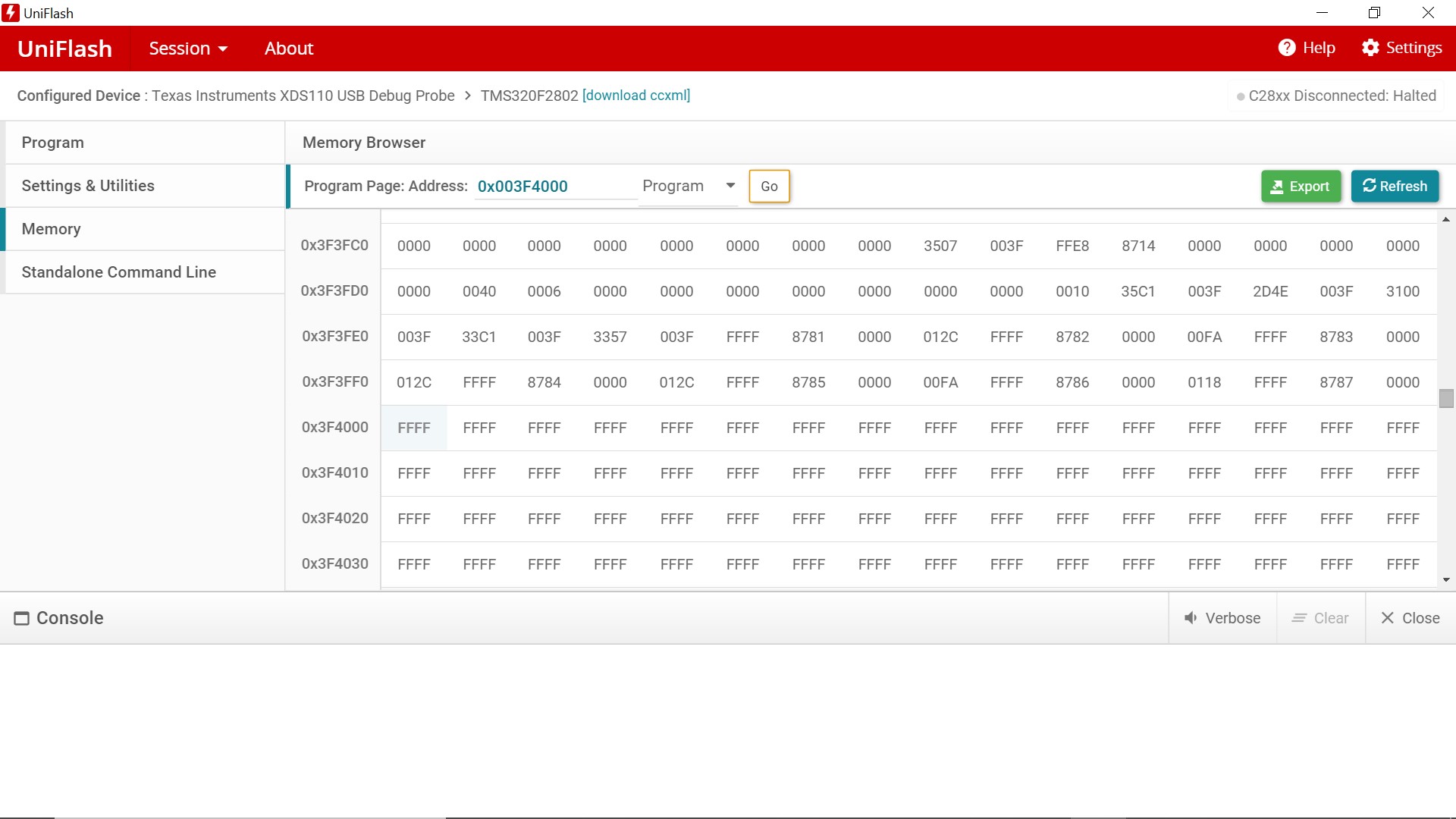

I'm resuming an old project based on TMS320F2802 to add flash programming function when I receive a SCI command from a host. To do this I use FLASH API v3.02 and CCS v9.3.0.00012. When I try to erase SECTORA (0x003F6000-> 0x3F7FFF) and write a buffer to address 0x003F6000, the buffer is written to the address 0x003F5F60. The sector is also erased from that address. Can someone help me?
Here is the code (ToggleTest return 9.9916KHz and Verify function return STATUS_SUCCESS):

  • I tried also erasing the SECTORB (0x003F4000->0x003F5FFF). I've had the same problem:
    So I tried to read the memory with UNIFLASH and I got:
    Now it appears correct.
    What is the correct result?

  • Hi Giovanni,
    If you refresh the memory browser in CCS does it appear correct? Does your application code run OK with the Flash_Verify() function being successful?
    If your code executes successfully I would think everything is OK and the memory browser may just be showing something weird or need to be refreshed.
    Have you evaluated the SW examples in C200w0are below?
    C:\ti\c2000\C2000Ware_3_01_00_00\libraries\flash_api\f2802x\example_ccsv5
    Kevin
  • Hi Kevin,
    If I refresh the memory browser in CCS doesn’t appear correct, it appears as the above image.
    At the moment I have not yet programmed my whole application code, I only tried to program some bytes after erasing one sector. I will do it shortly.
    I evaluated the API example for F280x DSP, not for F2802x. I believe the correct example for my project is the first one.
    Best regards.
    Giovanni.
  • I solved using View->Memory Browser: in this way I get the correct memory map.
    Thanks.
