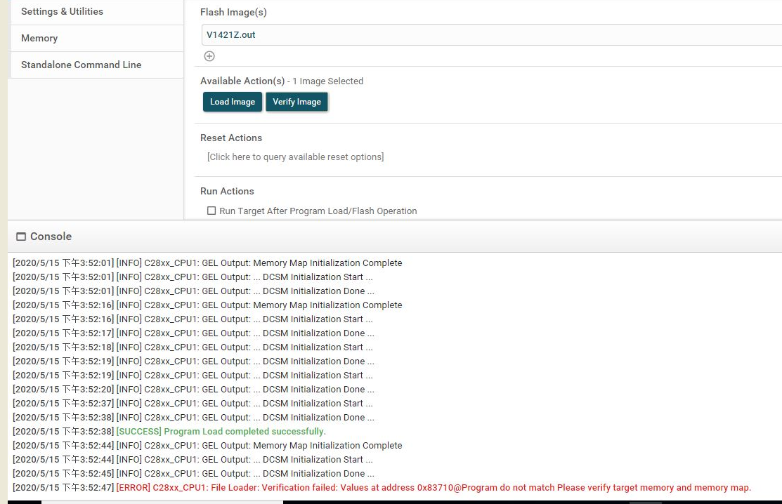

TMS320F280049: failed to verify image after "Load image" using UniFlash if DCSM is configured?
Part Number: TMS320F280049
My customer is using UniFlash 5.3.1 to program the flash. And they met an issue after loading the image. When they clicked "Verify Image", it turned out failure as below. The issue only occurred when they configured the DCSM. Could you please help check the reason? Thank you.

  • Hi Vivek ,
    It seems that their codes are fine, as below.  One more information for the issue is that, it only occurred when clicking "Verify Image" after the batch operation of "erase>>load>> verify" was completely successfully.

    Did you check if they are getting the flash ECC error as mentioned in other post ? Also I am assuming they are using COFF and not EABI format. Please confirm.

  • Hi Vivek,
    I don't think they got the flash ECC error, as shown in the posted error image at first. And I have confirmed that they are using COFF format. Could you please help the relationship between the issue and COFF format? Thank you.
  • Aki,
    Have you checked the Flash ECC error register as mentioned in other post to make sure there is no error ? I can not make it out from error image posted. Error will never say it's ECC error. Errors are always generic. Also please check NMIFLG register to see if there is any other error. We had some issue with EABI format but if using COFF file then it should be ok.
    Other basic thing to remember is, during verify, if DCSM is enable and correct passwords are not provided to unlock the device (or zone) then debugger can not read the secure flash sectors and will give this error. So please check if that is the case.
