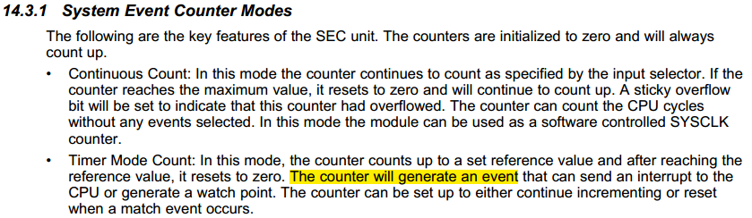

There 4 counter events for event selector of ERAD as shown below
what's the definition of COUNTERn_EVENT? The TRM describes the counter mode of SEC:
The event mentioned in timer mode count is the COUNTERn_EVENT?
Ok.
Another question: I noticed that there are some examples about ERAD offered by C2000Ware. However, all these examples need to run a JavaScript file. Is there any examples written by C language without using js files? I want the application code to own the ERAD module.
Yes, that is the event. Yes we have examples currently in the F28004x driverlib examples. They can be used for F2838x with very minor changes.
