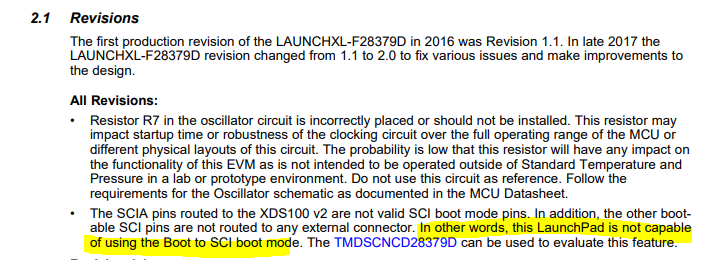

hey:
 I  use c2prog(1.8.6)  sci mode to download dsp hex file to DSP28379D launchpad,it works fail。I have asked TI engineer,she can't solve this problem.
I want to know c2prog surpport  the DSP28379D launchpad  sci programmer mode? If it supports,where have the example?
I have asked c2prog engineer,they peplyed as follow:
In the DSP28379 Technical Reference Manual file  :
when GPIO 72  Low and 84 High,it's SCI boot mode。if use sci boot,SCIA must use GPIO84 as TX and GPIO85 as RX by default?
If yes,the launchpad can not use c2prog to download?
