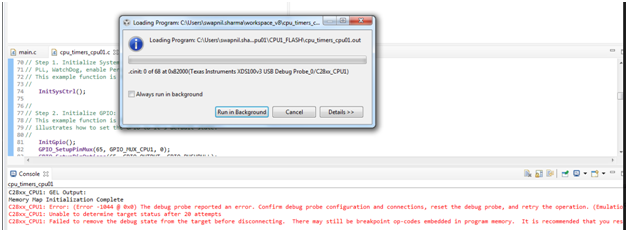

I am not able to load TI example program into TMS320F28075 using XDS100V3 debugger .
For your reference I am here sharing the screen shot of the error as well as CCS8.3.1 configuration settings.
Pl suggest what should I do to resolve this issue.
C28xx_CPU1: Error: (Error -1044 @ 0x0) The debug probe reported an error. Confirm debug probe configuration and connections, reset the debug probe, and retry the operation. (Emulation package 8.1.0.00012)
C28xx_CPU1: Trouble Halting Target CPU: (Error -1135 @ 0xC095) The debug probe reported an error. Confirm debug probe configuration and connections, reset the debug probe, and retry the operation. (Emulation package 8.1.0.00012)
C28xx_CPU1: Unable to determine target status after 20 attempts
C28xx_CPU1: Failed to remove the debug state from the target before disconnecting.  There may still be breakpoint op-codes embedded in program memory.  It is recommended that you reset the emulator before you connect and reload your program before you continue debugging.

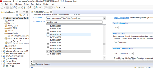

    Yes, I am using XDS100V3 of Olimex as an external debug probe.
    The screenshot of configuration for this is shared below:

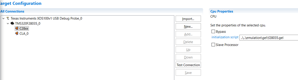

    Also pl find the GEL file & screenshot of the same.
    f28075.gel
  • Thank for sending the additional information. The gel file looks like it is the correct one for this device.
    There is not much else to check other than the clock, power, and reset on the DSP itself. Can you verify the following on the DSP pins:

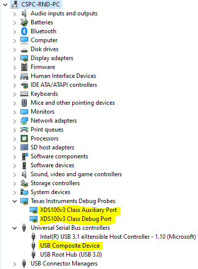

    One more question, do you see the driver files for your debugger installed in Windows? See the "Present in Device Manager" step in the JTAG connectivity debug document (SPRACF0).
    Can you also try to re-install CCS? Make sure to select all the Debug Probes when you get to that step in the CCS installation.
    Ans:  Yes, we can. The screenshot of the same is attached here.
